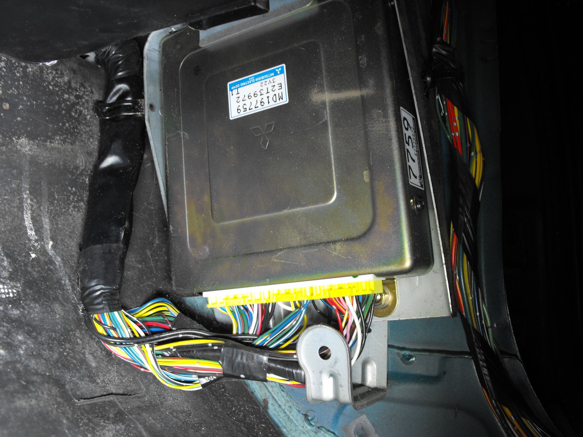

Today I finally removed the ECM which is located behind the passenger kick-panel:

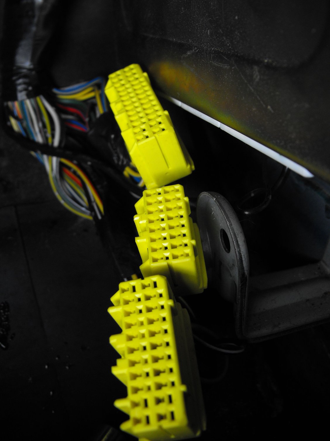

All the pin connections were in perfect condition:

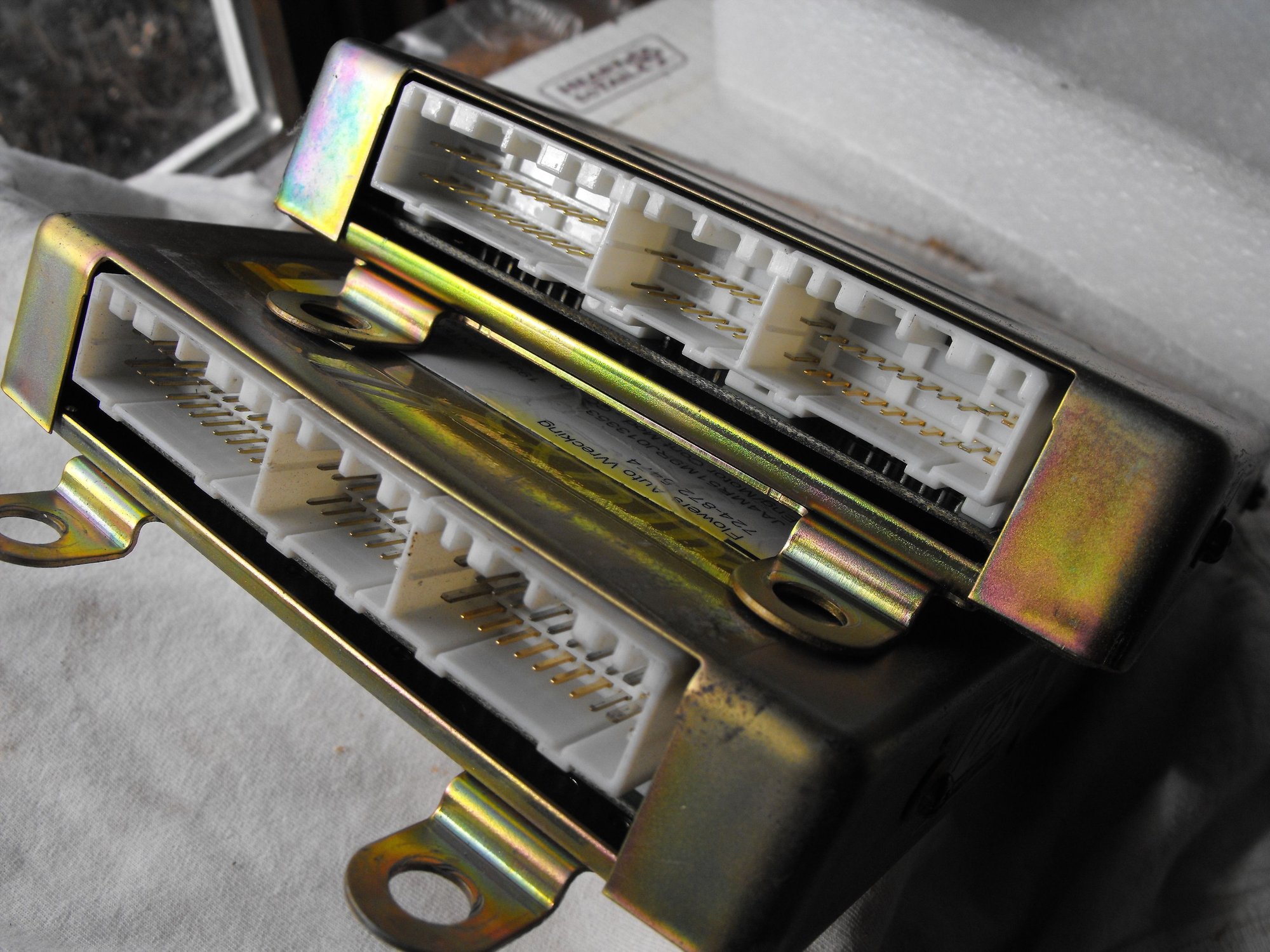

Junk Yard replacement ECM on bottom: All pins on both look to be in excellent condition.
I installed the replacement ECM, and hooked the battery back up. The engine still runs at exactly 1500 RPM at Idle.....no change from the original ECM that I removed. After driving it several times on trips exceeding 30 minutes, it still idles at 1500 rpm.

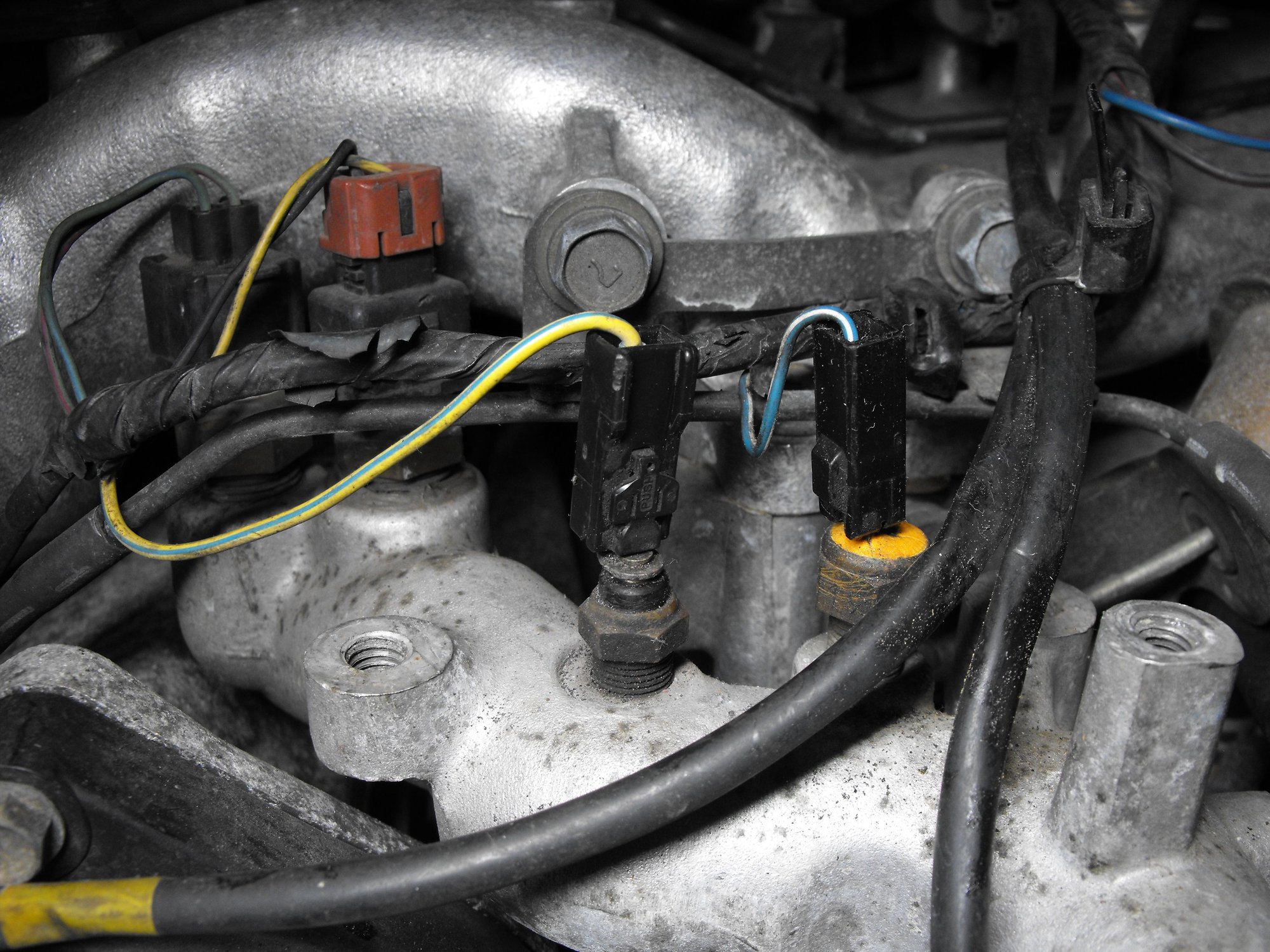

I now have another thought......Can a bad coolant temp sensor also cause the ECM to cause a high idle? There are actually 4 coolant temp sensors, and I believe one of these sends the signal to the ECM while another sends the signal to the dash temp gauge. Im not sure what the other two temp sensors are for. But could a faulty one cause a high idle issue?
