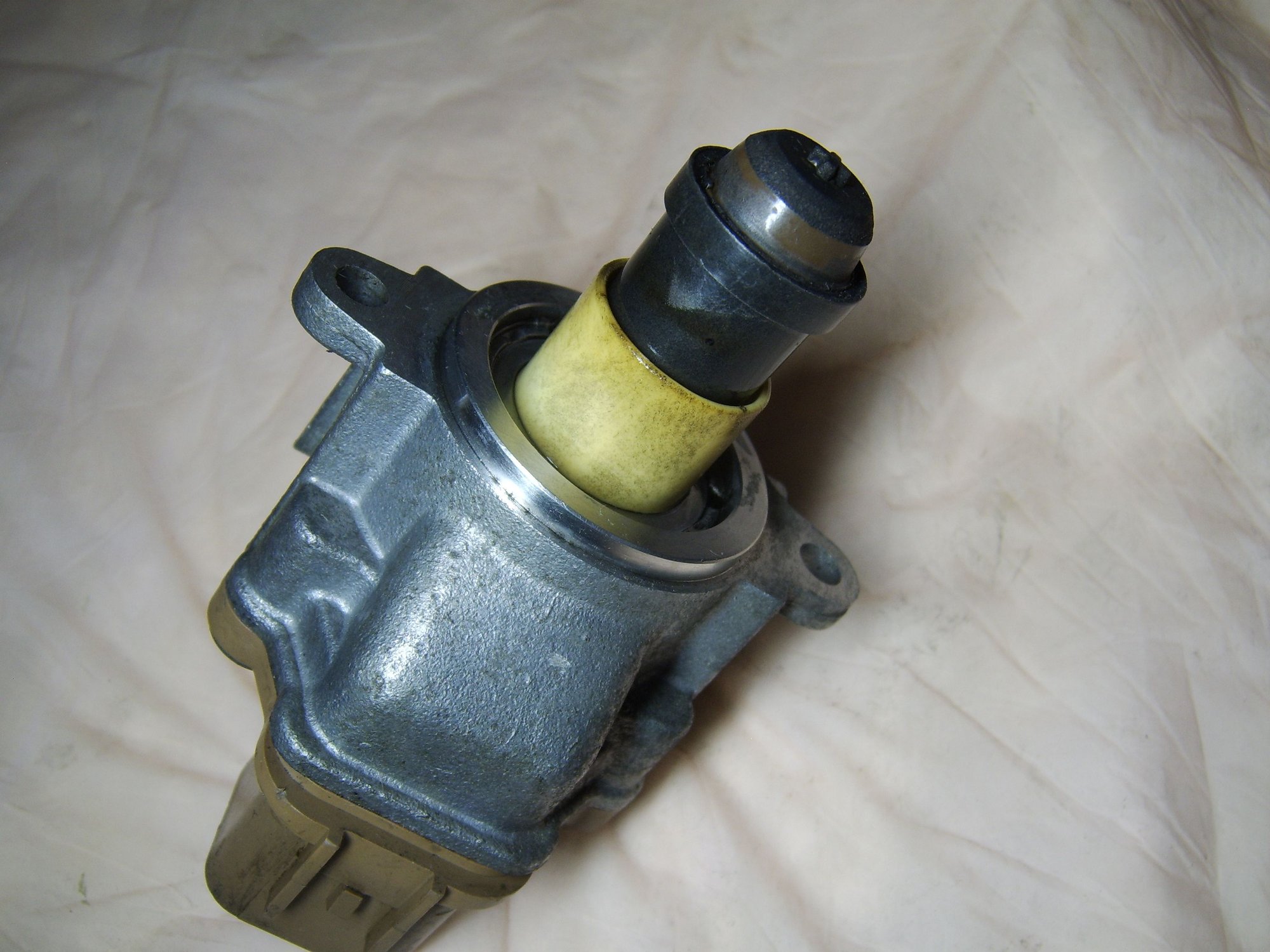

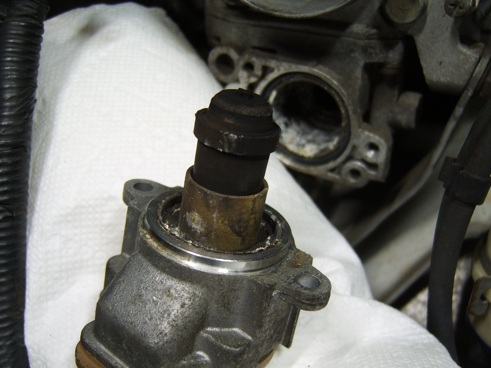

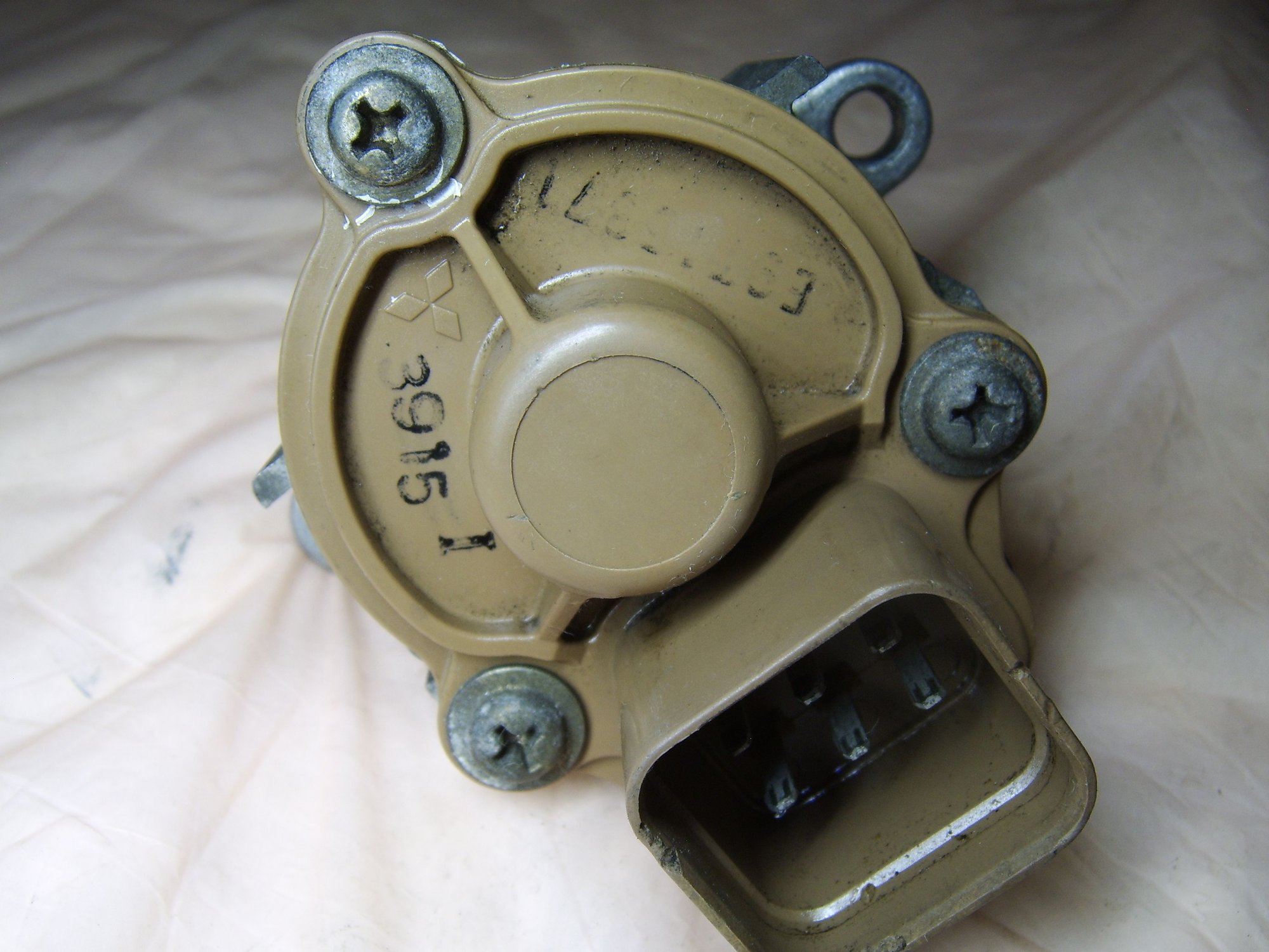

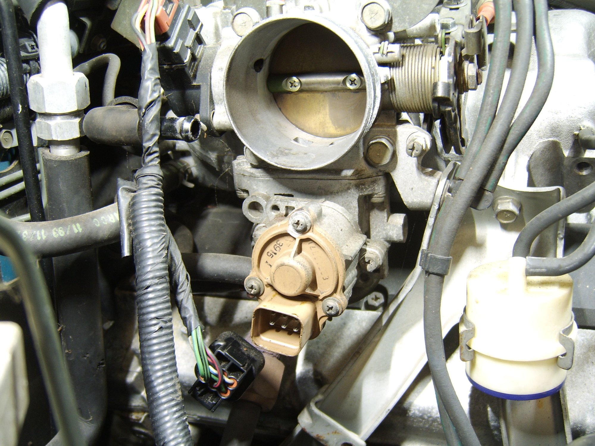

Here is a pic of the Idle Air Control, seen unplugged in the pic:
This was an original OEM Mitsubishi part, and did have a fair amount of grime on it:

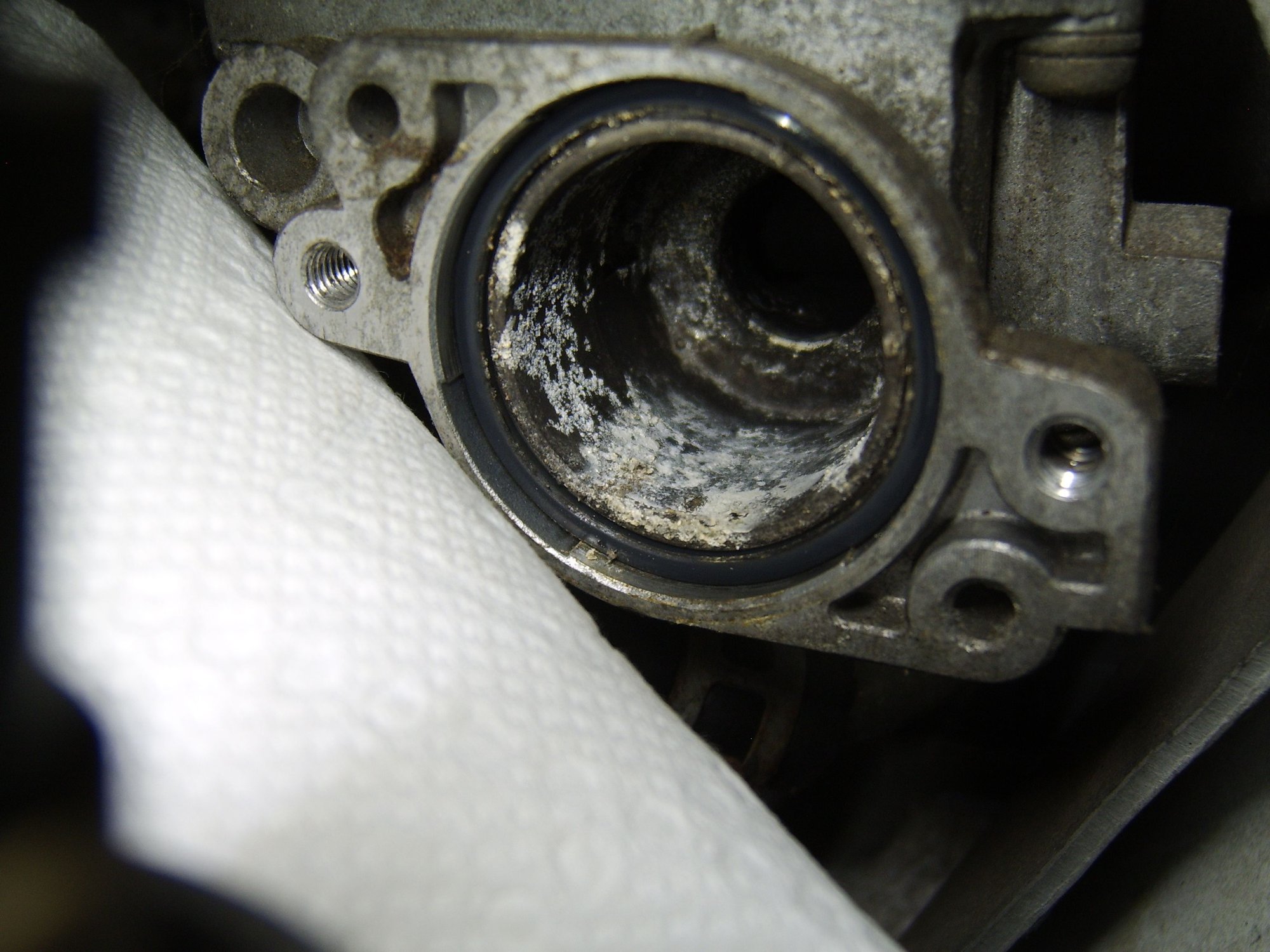

Also corrosion on the inside where it mounts:
Cleaned it up, along with all the corrosion in the mount area, and re-installed it to see if it would work. Nope.......engine would start up fine, but would not idle.....would just drop RPMS down to 0 and stall out.

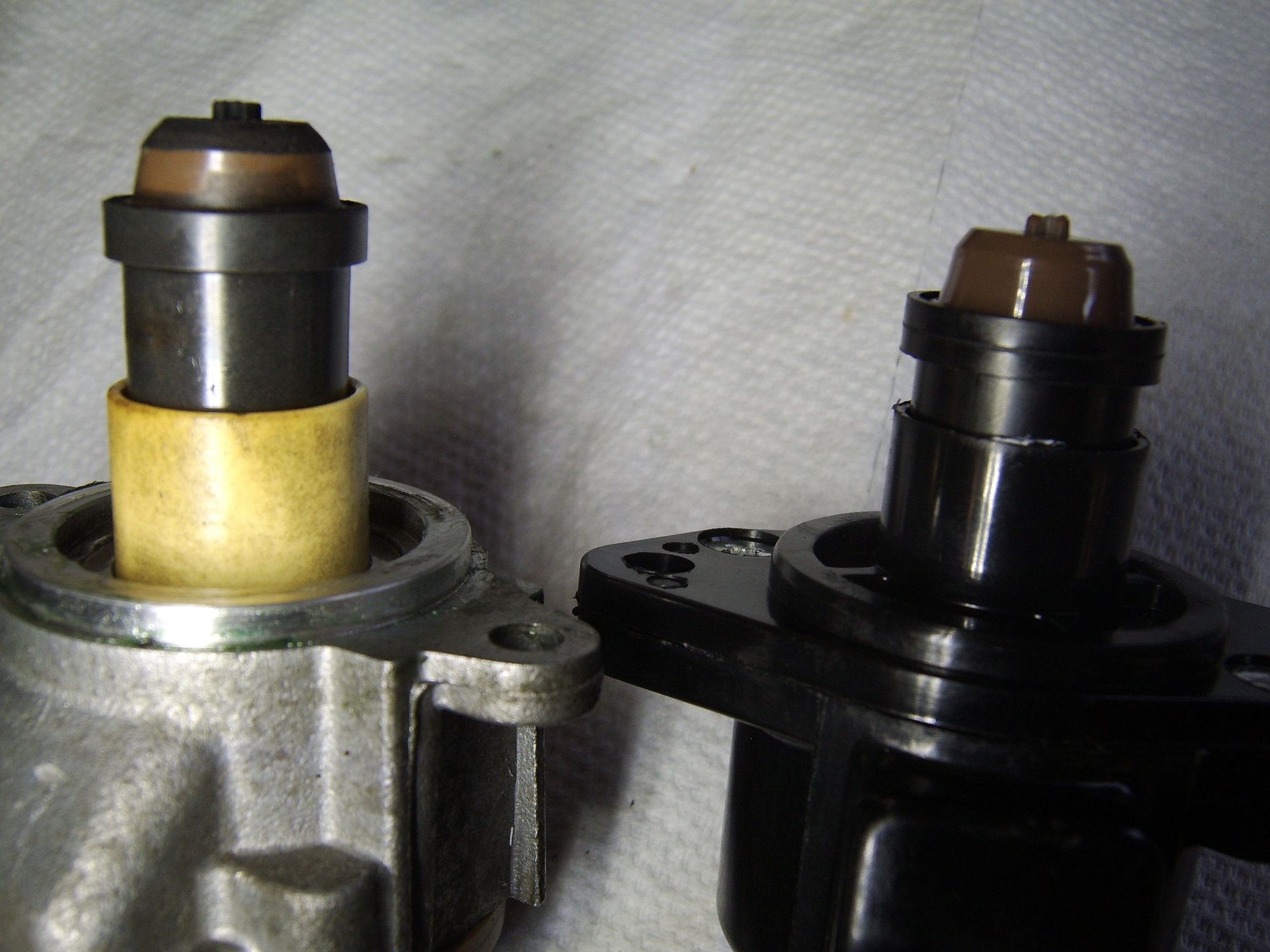

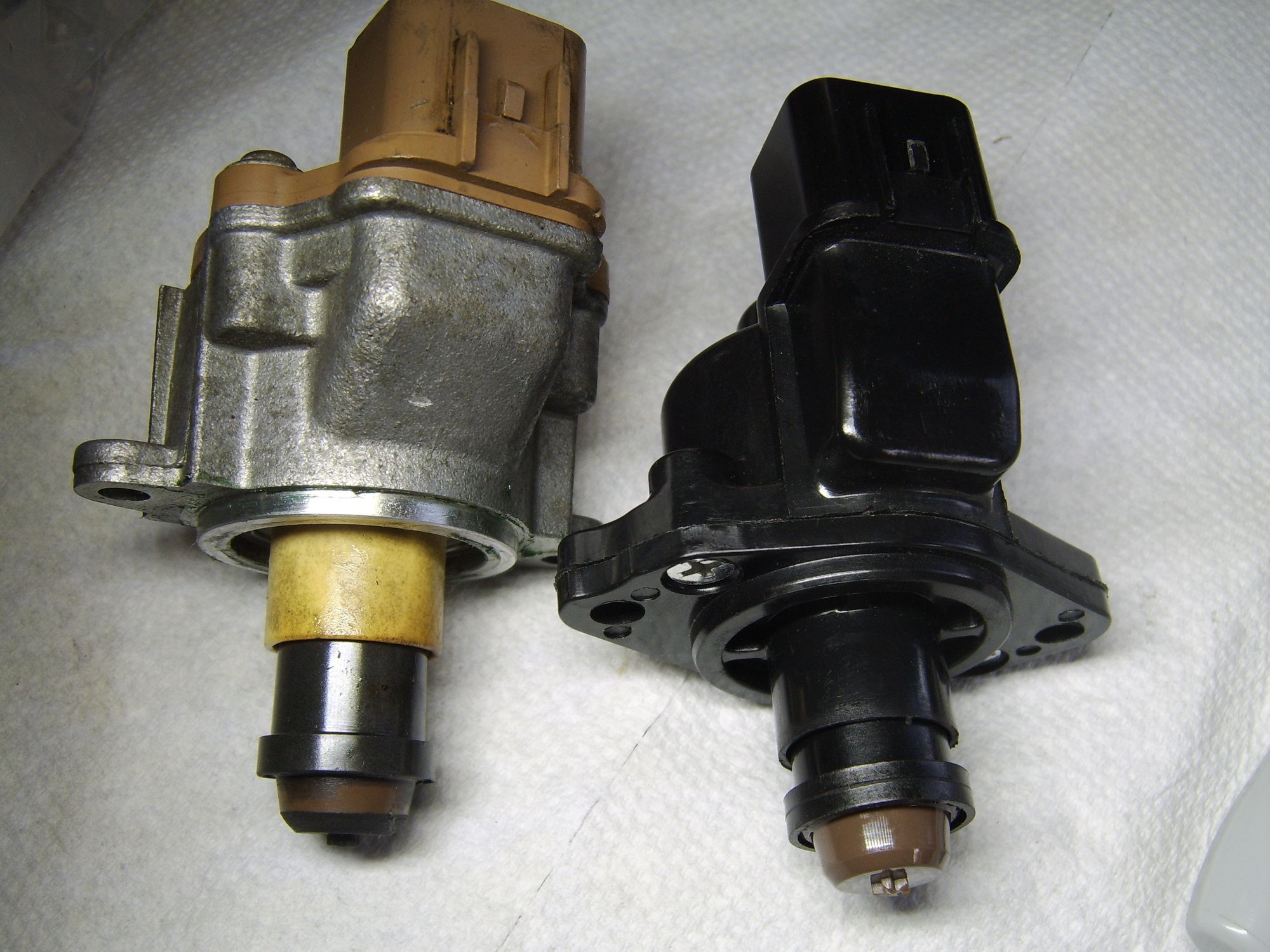

The price for an OEM Mitsu. brand part is crazy high.....3-400 bucks. Rock Auto had knock-off brands for $50. I forgot to check eBay, and sure enough, I just found the same part for less than $20 on eBay. Here is the new one vs. the better quality Mitsu old one:
The Mitsu one is made out of real metal, whereas the knock-off ones are all plastic.
(Also, the knock-off one will not "snap" into the harness.....the little tab is a bit smaller than the OEM one.....so, I will probably have to duct tape it to help ensure it wont vibrate out.........Growwwwllllllll!)
Another potential problem is that the Mitsu OEM metal one allows the "probe" to stick out further than the knock-off brand does, as seen in this pic: Thus, the knock off one will immediately be allowing more air flow to pass at idle, resulting in a higher idle speed. Unless, the computer picks up on all this data and adjusts everything to allow the engine to idle back to a normal RPM.
After installing the cheap knock-off unit, I hooked the battery back up and cranked her up. She does idle now, but its way too high....about 1200 RPM, instead of about 650 RPM where it used to idle.
So, question for Hunter and the experts........Will the computer adjust its settings to allow the idle to drop back to the normal RPM? Or is this just a problem of buying a cheap part? Any other way to adjust the idle back down if the computer does not take care of the situation?

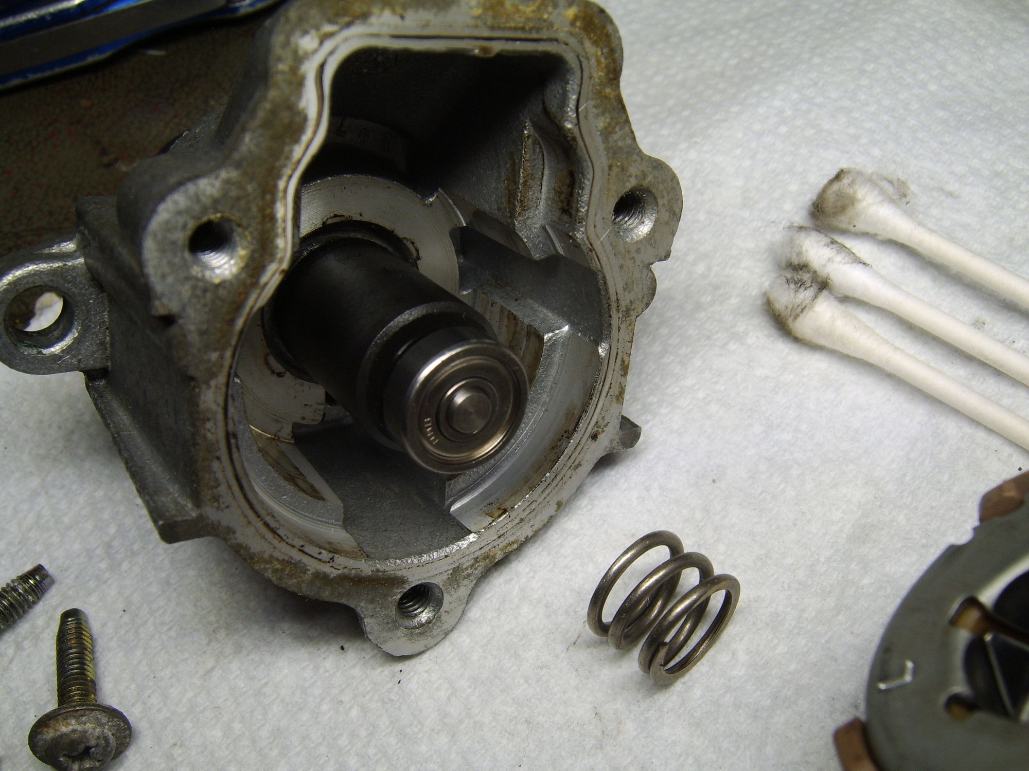

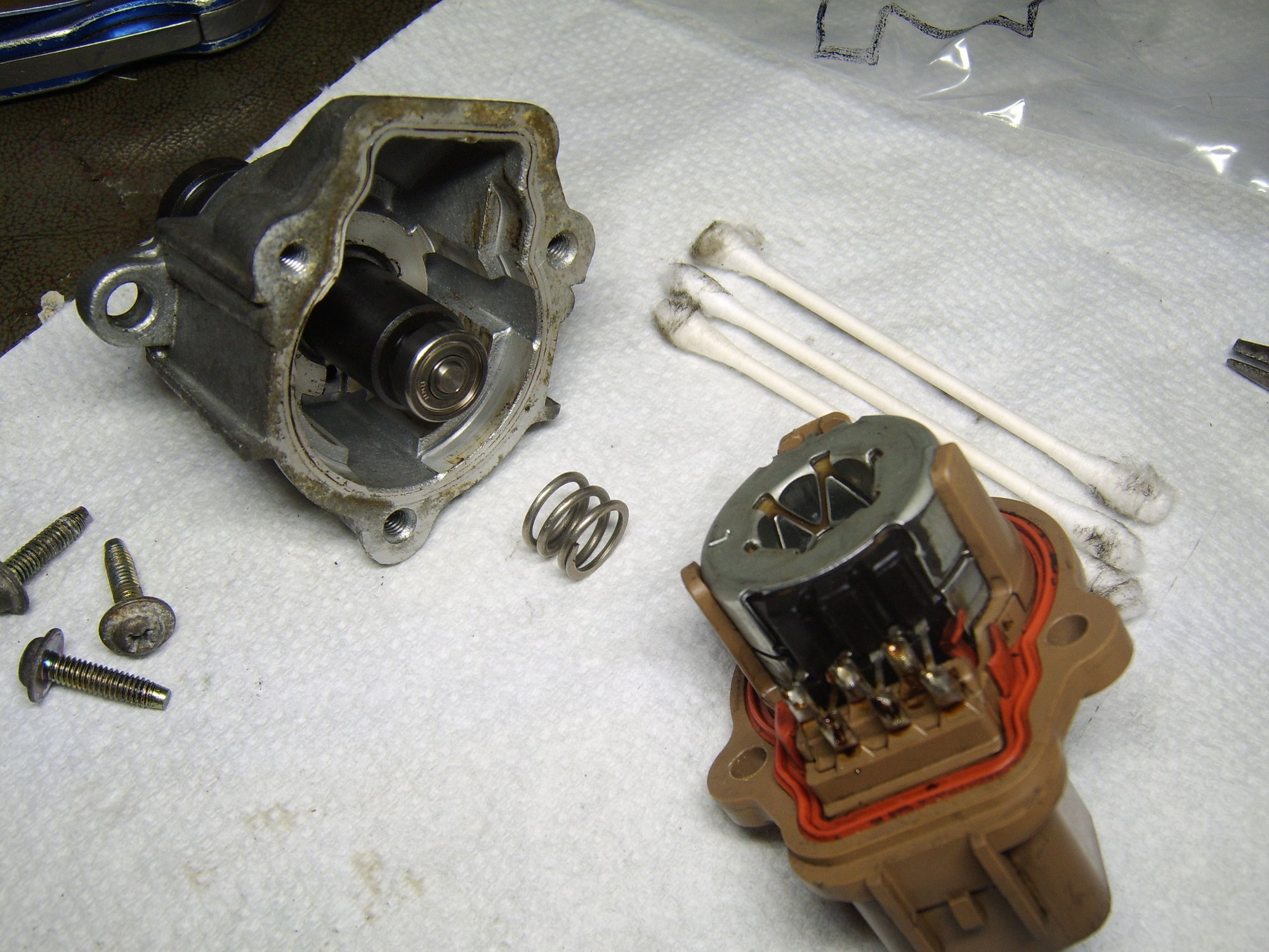

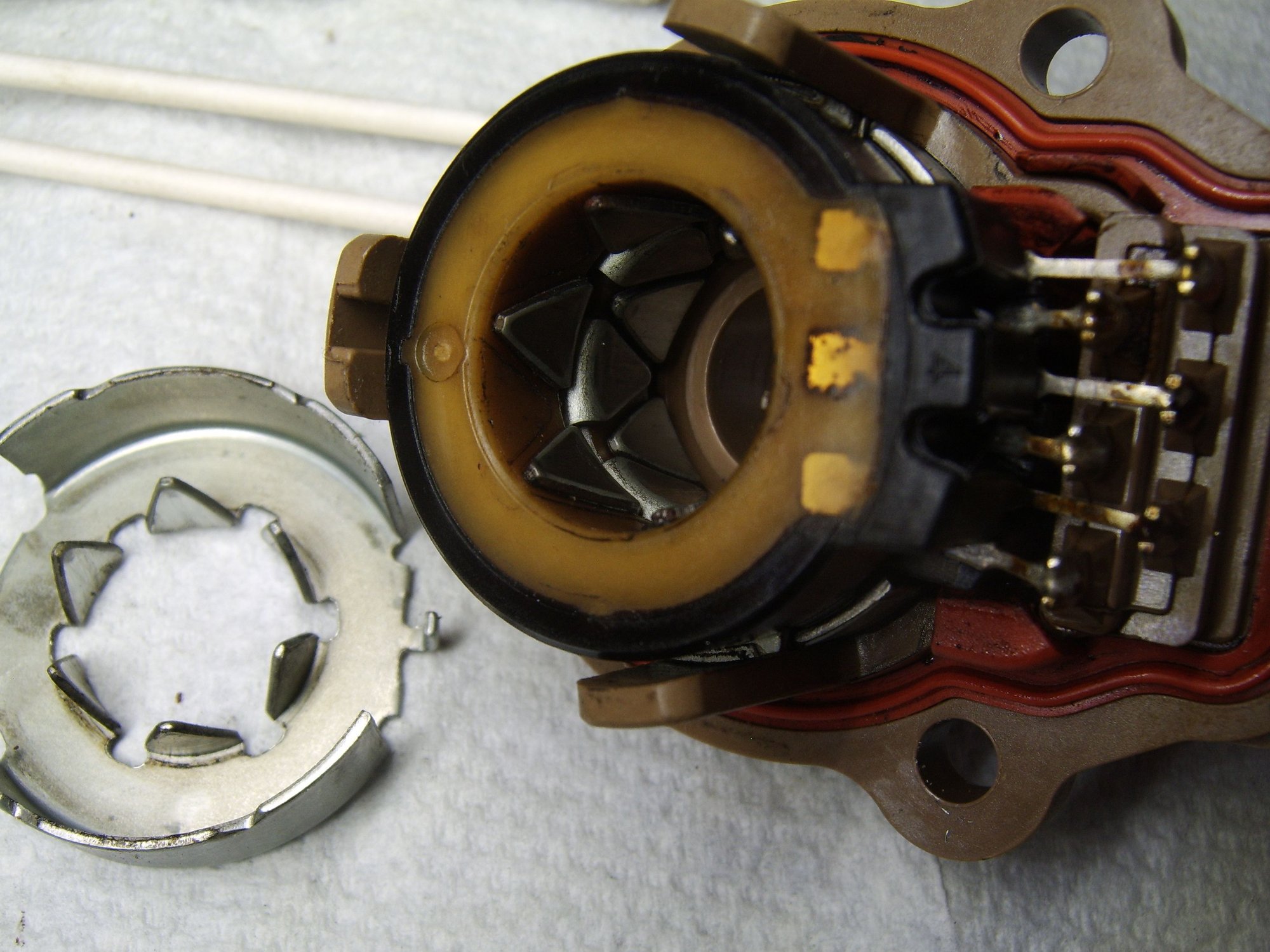

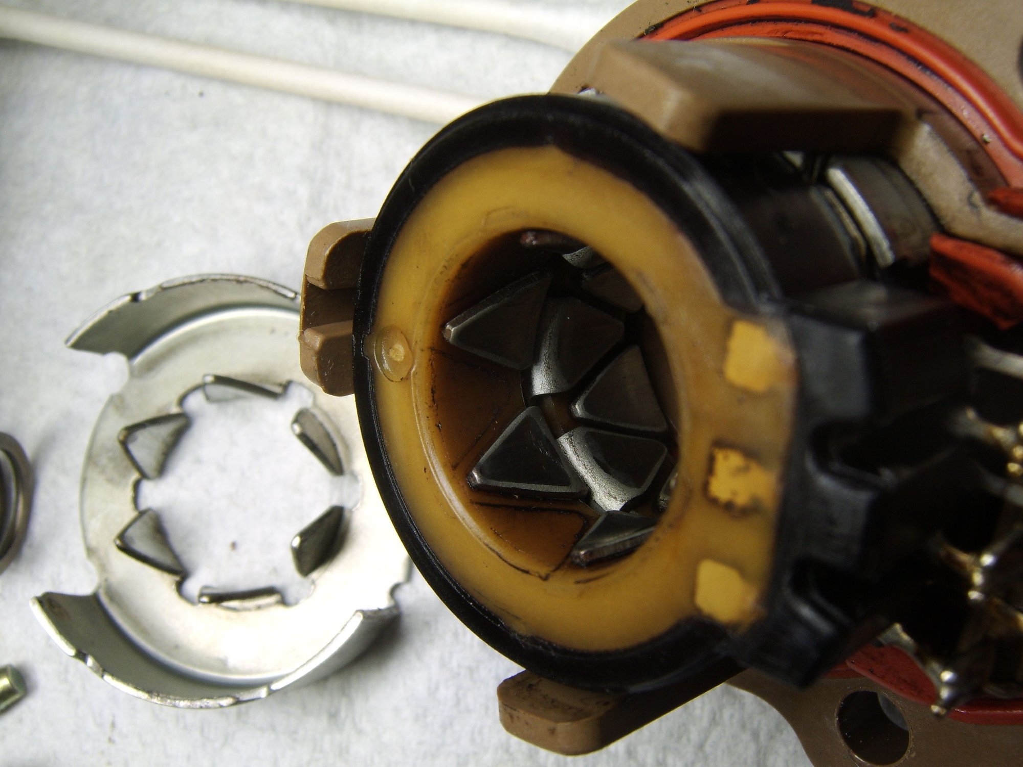

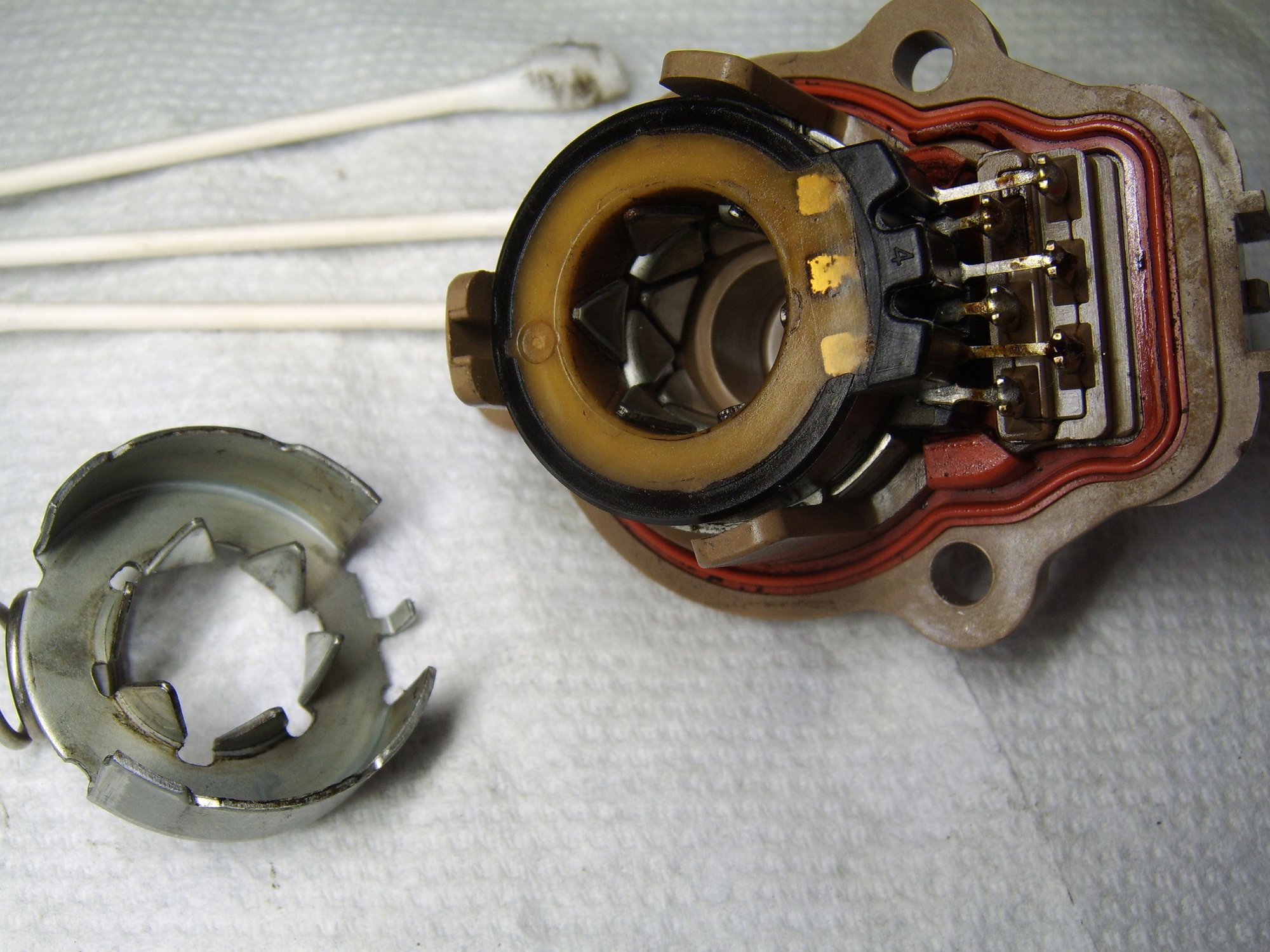

Curiosity Killed tha Kat: I took apart the original OEM defective switch:
Appears to be an electromagnetic solenoid, and has small "triangles" on the inside which are connected to one of the 6 power leads. I guess 5 power leads are for various levels of current flow going to it, and one for a ground. So, looks like the solenoid should "pop" forward in 5 different increments based on how much current flow is going to it.....and the ECM or computer gives these orders. I used QTips to clean the surface area on the "triangles" and got some gray grime off, which may have been restricting the in-out motion of the solenoid. Could be that it was just "sticking" and would not open. All 6 wire leads look good, not broken off.
Small bearing on this shaft was fine. So, maybe just a good cleaning will "unstick" everything. Will put back together and give it a another try if the new "el-cheapo" one fails to allow idle to go back to the 600RPM range.
Any other suggestions?

Nice job disassembling the IAC. It is most likely a duty cycle solenoid, i.e. it turns on and off many times per second to allow just the right amount of air flow in. Not sure why you'd need 5 separate wires for that? Perhaps some are the feedback control loop to tell PCM how far the pin is moved in or out. It would be intetesting to see if internal cleaning had done any good. You are pretty much on the same track as I would be with it. You know my approach - if it's already not working and it got screws holding a cover on it - open it up and check it out. You really can't make it worse at this point. Thats the reason I have an automagic transmission from my daughter's car sitting on the bench now...
Now, back to IACs. I've never had to deal with them myself, but, I recall reading about an idle re-learn procedure on some models. I'll try to find it and post a link if I do.

Hunter.....Thanks.....those 3 screws were on super tight, but I arm-wrestled that sucker and won. I believe that the 6 wires are needed as the computer will tell the idle to increase some when the AC is turned on, or if it goes into Drive, etc. So, I guess the computer sends power down whatever wire is needed to make the IAC pop out a bit further which allows more air to flow to the engine, and thus making the idle a bit higher.
Will clean well, and put back together and may go ahead and try it to see if the idle then goes back to the normal 650 as opposed to 1200. What bothers me is that the knock-off unit did not stick out as far (29mm vs 34mm), so it would make the idle faster just because of this fact.
