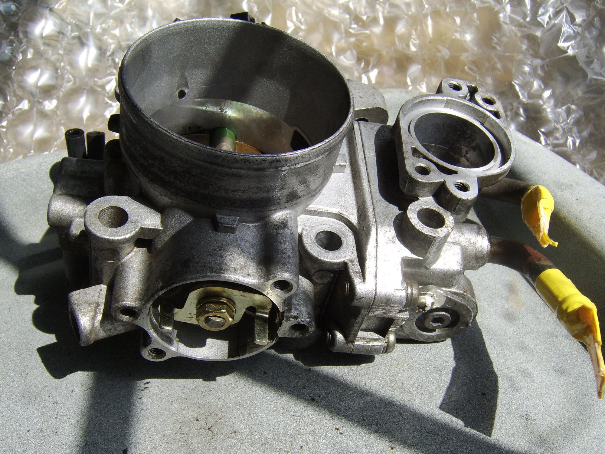

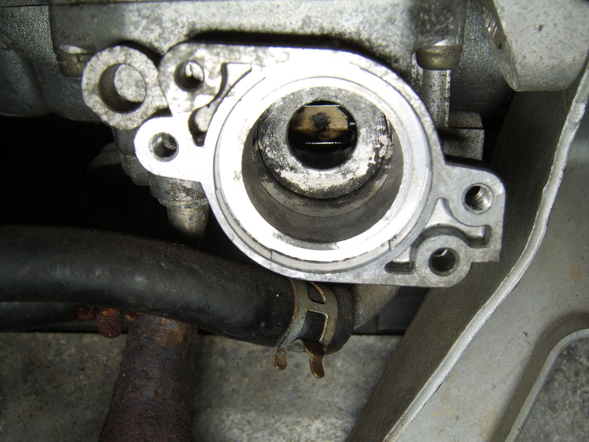

Hunter.........Just had another thought: The throttle body has coolant lines running up to the area where the IAC "idle control valve" is located. There is a bi-metallic spring (I think?) that is supposed to expand/contract which also allows more or less air to help with the idle. When I did the thorough Throttle Body cleaning, those 4 phillips screws were so tight that I just left it alone. I did verify that it was not clogged by spraying penetrating oil in the lines. Do you think that a "stuck" spring up in this coolant area would be enough to cause the idle problem? I personally doubt it, but wonder what you think.
Here is a pic of the Throttle Body base where the IAC mounts. You can see the coolant lines on the bottom, and then a brass-looking valve (or something) down inside where the IAC shaft goes in/out. Do you think that brass flat "thing" is another "valve", and if it is stuck it could prevent the IAC from actually working?

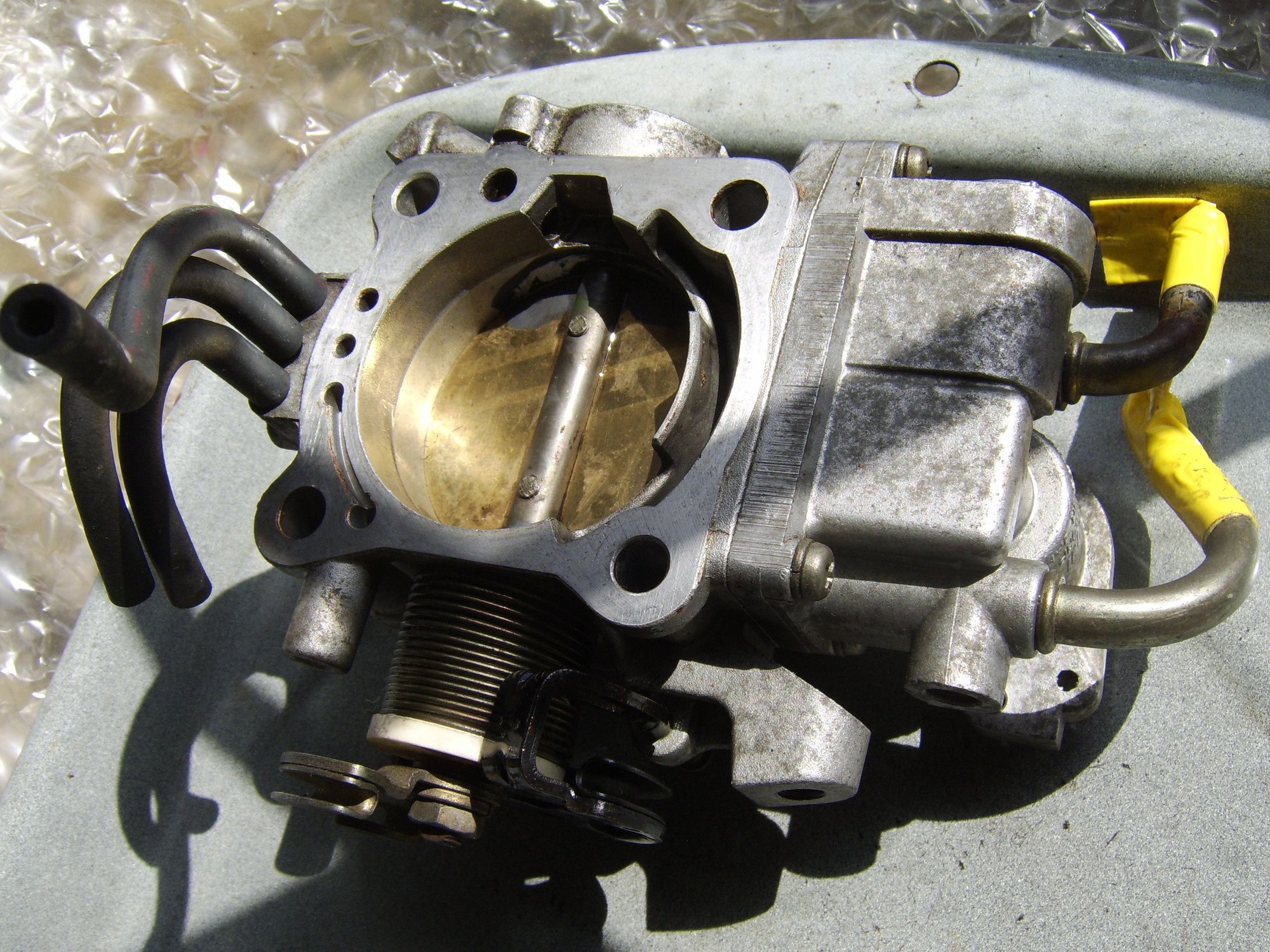

Here is another view.....4 phillips screws hold it to the throttle body:
In this pic you can see the factory white paint on another phillips screw that holds what appears to be an "adjusting screw" (to left of the yellow tape):

I know when I cleaned my throttle body I took out that little plastic flapper valve (dunno what it's called) and cleaned it thoroughly, it was so junked up with carbon soot that afterwards it idled better than it did. I memory serves me right, there's a spring or something in there as well. This system works in tandem with the IAC so it stands to reason it needs to be cleaned. I would have mentioned it earlier but since you mentioned you cleaned the TB I just assumed this was done as well.
Old Aug 21, 2020 | 07:58 PM
  #48
I do not know is the bi-metalic spring/valve could be stuck. Anything is possible. If the screws holding the cap are super tight, you need to get manual impact screwdriver. With it, you can pop loose those pesky screws without mangling up the phillips heads. Take it apart and see what else you can clean/free up.

Naeos.......Yep, I wanted to remove that coolant assembly piece, but was too lazy to stick the TBody into a big vice so I could use an impact wrench/hammer to break those 4 phillips screws loose. DOHHHHH! But this coolant "valve" only sees incoming fresh air that comes through the IAC, so there should be no carbon built up in this one (I think?). But it still could be "stuck" and causing issues. Might have to take it all apart again.
On the other side of the Throttle Body is the EGR which does see a ton of carbon/oily crud come thru from the engine on its way to the Throttle body.....I did remove and clean that one.
