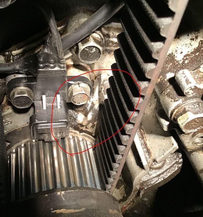

The more I thought about the timing, the more I doubted myself. Then I started thinking this could be an easy fix...foolish me...
I pulled off the coved and checked the timing, and everything looked fine. I'm going to have to keep looking.
Here's what the timing marks look like on the crank. The mark is on the back of the gear so it's easy to see with the pulley still in place.
Timing marks on the crank with the pulley in place.
