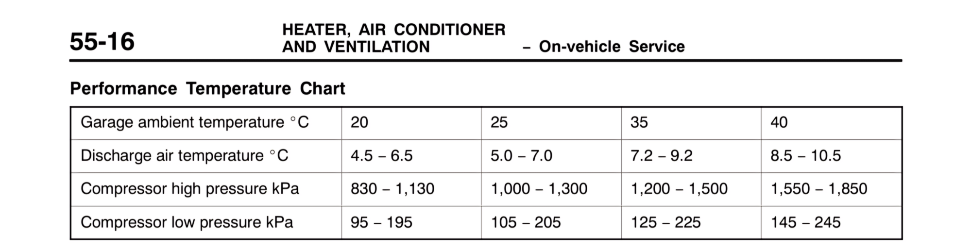

Nope. It may have gotten a little colder (probably thanks to the damper fix) but it's still not comfortable enough for me. What is interesting though, is that according to the service manual, the temps I'm getting are actually normal. Here's the chart they give:
It was about 75 F while testing, full cold, recirc on, and I was getting around 42-46 coming out of the center vent, same temps coming right off the evaporator. According to this chart, that's right about where they should be. But I took it on a drive for about 30 minutes or so and I just never felt comfortable, even though temps stayed around 42-46. Out of curiosity, I tested my mom's suburban (which I know gets plenty cold even in the heat of summer) and it's around 42 coming out the vent!!!
What!!!??? How come my car feels so much hotter in the cab despite the discharge temps being so similar?
There must be something I'm missing. What are your guys' AC temps like? Does it actually feel cold enough in the heat of the summer?
