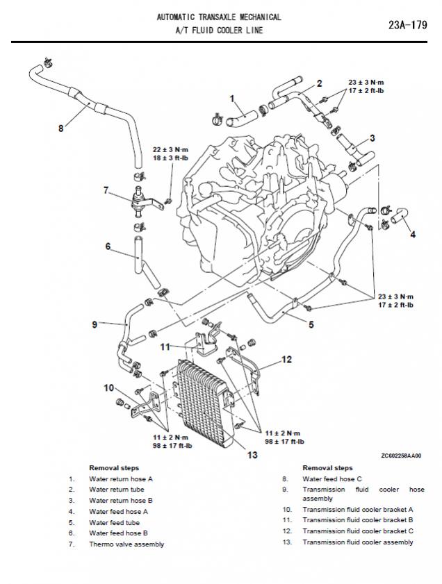

No, the transmission cooler definitely shouldn't just be dangling there, I'd zap-strap it to something to prevent it banging around.
There's no grill in front of the oil-cooler, but there is a duct/cowl. You should have a section of engine room splash guard below it that connects to the splash guard in the wheel well (which you are missing half of).
I've attached some diagrams.
