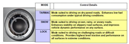

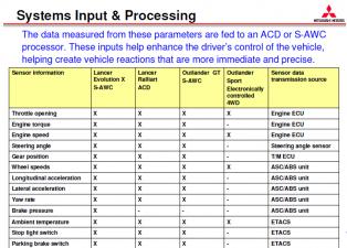

The GT does not have a 2WD mode it's always 4WD.
The description is available in this Power Point presentation page 20 to 28.
The rest is covering the EVO X, the RalliArt and the new Sport.
http://media.mitsubishicars.com/chan...d-b1694c33996b.
Keep in mind that the Outlander is a Road beast (Better than most Jeep in the snow) and not designed for Off Road prowess and is obviously not Rubicon Trail rated. (Uni-body construction)
It has an electronically controlled front Differential and the same at the rear as before but a host of new sensors.
