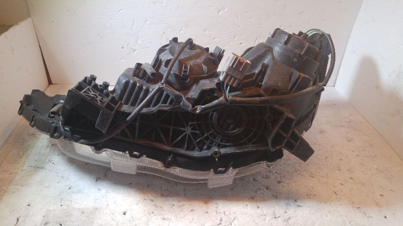

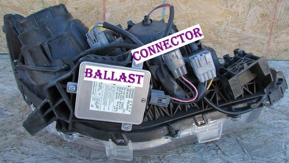

The headlight housings are the same for the HID and halogen equipped models but the swap is not as easy as you think. You would have to put the headlights into an oven to soften the glue that seals the front polycarbonate glass to the plastic body in order to disassemble the headlight. This is a fairly delicate job as you should avoid any warping. People, who installed LED stips and or switchback turn signals have done this but for a novice person it could be risky. Yes, the place for the ballast exists even in the halogen headlight (see attached pictures). Check out junkyards, whether you can find an HID headlight there or even on ebay or Craigslist. These options are definitely cheaper than OEM (even the halogens) new copies.
