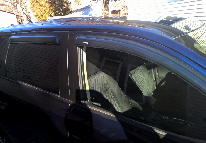

So I've got my new 16 Outlander now and back home to start modding on it. I'm a bit OCD on the looks and as always will be removing all the badging and dealer stickers,,,, so,,,, with a break in the weather, I got a little bit of progress done on it.. For starters: put the AVS vent visors on it, Got the rear De-badged, (there's a body "divot" in the back and it's "inset" where the triple D's go) I also took off the engine cover, gonna do some paint work on the diamonds and I think I'm going to use all the lettering I took off the back, paint it the same as the diamonds and it'll spell "outlandish". Still waiting for the RRM crank pulley and timing controller to show up.

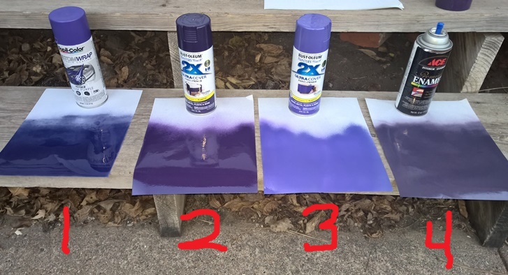

I got some samples of what color Purple to put on it and accent stuff, engine bay, etc... Let me know what you think??? I'm leaning to #2 first choice, and #1 second choice. (to also cover the Chrome trim)

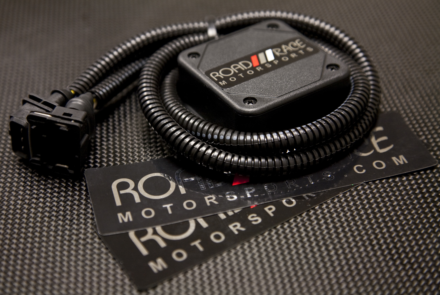

Installed the RRM timing controller today before going to work.
not a whole lot of difference in the way it idles or runs, but I can tell the difference it the RPM's when hitting the gas and power output to the ground when taking off is noticeable too. More responsive....
Plug N Play is as easy as it gets. The mounting in the engine bay is simple.
Plugs are slightly different on the 2016 model, (outer shape) but they still hook up and connect in the same way.
I'll get some pics of the install and how it's mounted. It looks like it's meant to be in the engine bay, and if I ever needed to quick connect back to stock, I could just undo it and ziptie it out of the way.
At highway speeds, it feels smoother and passing "pedal down" is quicker, not so I4 feeling. More like a weaker V6 but noticeably better than stock.
RRM Timing controller for the 2.4 Lancer I can attest "WILL" work on the 2.4L of the SOHC Outlander or Outlander Sport. It is currently on my 2016 Outlander SE, 2.4, S-AWC with NO issues....

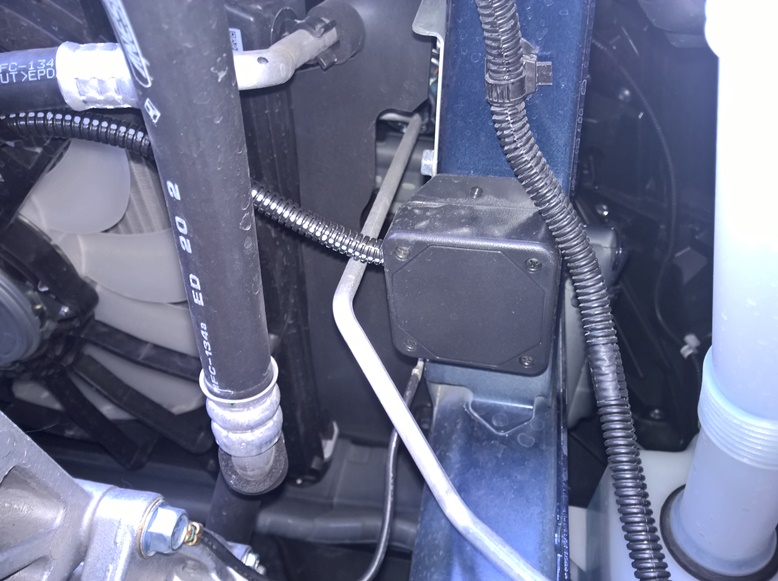

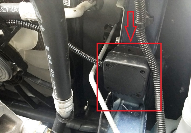

Timing controller mounted. Pics included.
This thing is a good addition for a lil noticeable zip in response. Box without the RRM sticker looks just like anther part of the engine bay that belongs there. Connections are simple and I only needed one zip tie to secure the harness. The controller plugs in just to the left looking down by the alternator and the plug pulls off right at the manifold. (shown in the pics) simply plug the stock connector into the harness, and same style plug connector from the new harness back into the plug at the manifold. There is a nice spot for the control box on the front of the radiator support/chassis. The 2 sided automotive tape is enough to hold it in place, but you could always add a few screws (or drill and pop rivet) to the chassis.
Controller has been working well for 2 weeks now with NO issues, running 91oct. MPG's haven't changed from either "NORMAL" mode or "ECO".
Normal is better in town for performance, ECO, is still good on the Hwy with noticeable improvement in acceleration merging from the on ramps.

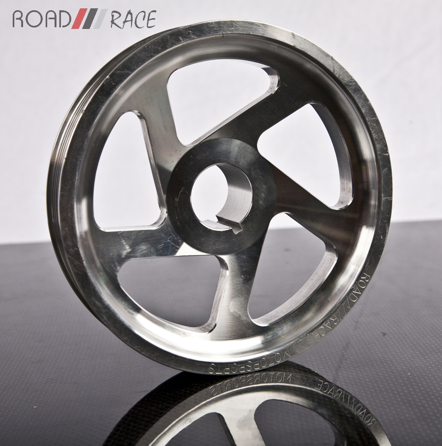

As for parts for performance, RRM,, "Road Race Motorsports" is the only game on the web for true dedicated performance upgrades. I'm currently working on another forum that will have all the page and parts info by year and model for the Outlander and Outlander Sport. I will share that here as well. I've used RRM parts on the last 3 Mitsu CUV's I've had. 13 Sport w/ 2.0, 14 Outlander, and now 16 Outlander.
A few of my friends use RRM parts on their EVO's just cause they're so reliable and well made. (not knock off junk)
Good luck with your new Outlander, there's plenty of stuff for consmetics on the bay or amazon. If you want performance,,,, RRM is your best bet. (only bet) I recommend the pulley for sure.......
