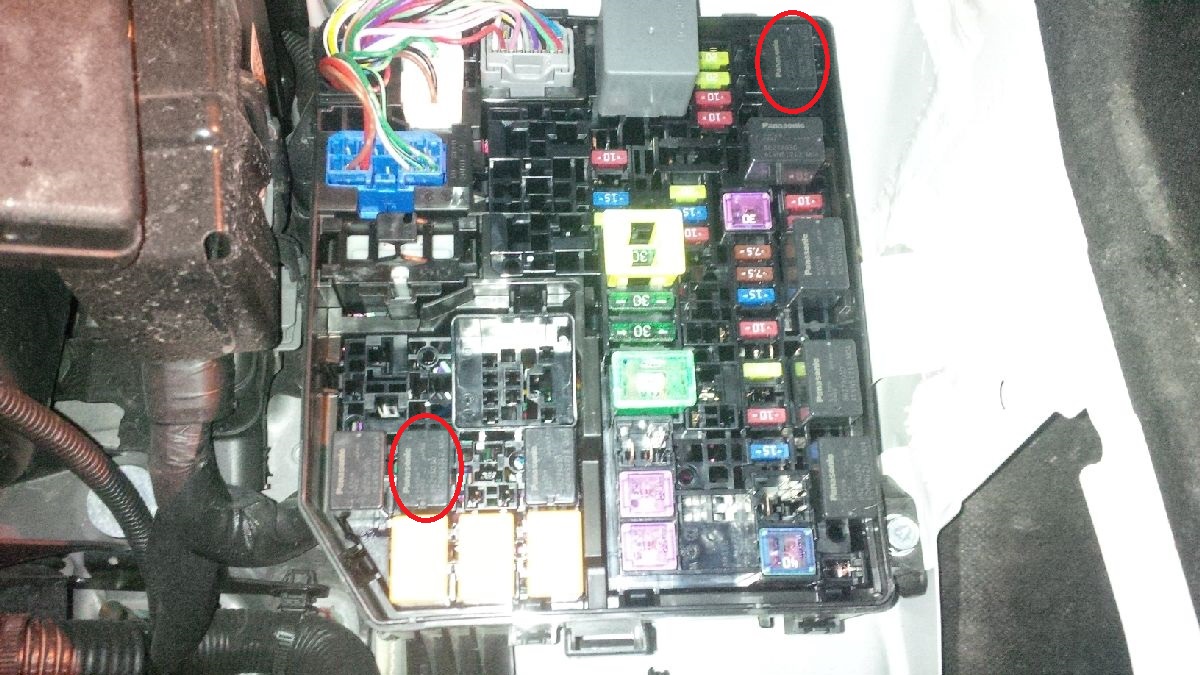

Sure. It's not that hard (once you figure out all the pieces), but there are a lot of potential hiccups with ETACS that I was fortunate not to encounter unlike many others. Also, one caveat, my DRL's are basically the regular headlamps right now. I can't tell if it's lower intensity or if there is anything different about them at all. They are not the parking light LED's only. I still have to play around with some ETACS settings to see if I can get the parking lights to be the DRL's, but I'll take this for now. [edit] I got the parking LED's to act as the DRL's. Instructions edited below.
1) Need to move (and later replace) a relay in the engine hood fusebox. See attached pic. The circled relay in the lower left is missing on the 2016 (possibly other years, but I don't know for sure). I removed the de-icer relay two slots to the right and put it in the DRL socket for now. [edit] Ordered replacement relay from digikey.com. Part to search for is Panasonic ACVN51212. $7 including shipping.

Attached Thumbnails 2016 Outlander SEL DRLs not coming on-img_20160304_182330-edit.jpg
