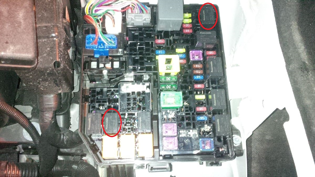

Default Help from Canadian 2016 owners?
I read in the ETACS thread that the DRL relay might be different from the regular relay. Can a Canadian 2016 owner take a pic or check your fusebox under the hood to see? I've attached a pic of what my US 2016 fusebox looks like. I circled where the missing relay is. I tried a regular relay by just moving one over their, but it did not work. I suppose it doesn't need to be a 2016, since the ones after 2012 did not have DRL, but just to be safe. Any help from up north would be GREATLY appreciated. Thanks.

Thanks to turbocolts for hooking me up with some pictures of his Canadian model (working DRL's). The circled relays are the ones related to DRL's. You can see from my earlier pic from my car that the US is missing one of the relays. I had tried putting in a relay there, but it didn't work. So I was hoping that the Canadian version would have a different relay that would explain why my relay placement didn't work. The pics confirm that it is the same relay that is used as all of the others (same as the one I tried). Therefore, a different relay is not the problem and not the easy way of reactivating the DRL's as I had hoped. There is still something else missing that is keeping the DRL's from being activated. As far as I can tell, the only thing missing is a relay there, but that alone is not the problem. All other fuses and relays related are in place.
The suggestion is now to compare wiring diagrams of the Canadian model to that of the US model. No idea how I'll track this down.
To summarize my attempts I've asked the dealership shop (unaware), the regional manager (unaware), Mitsubishi USA hotline ("the US models are not equipped with DRL's" - completely unhelpful, checked fuses (good), checked relays (missing one easily attainable at a nominal cost), now a dead end.
Any other ideas from interested 2016 Outlander owners?
