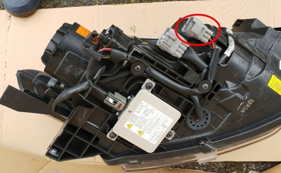

4. If your model does not have HID head lights you can enable DRL (to normal, not independent) in your ETACS if it is not done so and find the wire that delivers the DRL power (in my case it is the wire that would power the ballast for the HID equipped trim, see the attached image with a red circle identifying the connector).
That should give you 8-9 V when the lights are off (in reality this signal is modulated by a FED that fluctuates the signal with some ~100 Hz or so between 0 and 12 V giving you an average of 8-9 V) and 12 V when the lights are on.This labeled connector is a dead end in the non HID models (at least in my Canadian OS/RVR) but the wire is powered if "NORMAL DRL" is enabled. I believe if independent DRL is enabled you would have constant 12V in the wire going there but not 100% sure). If you wire your fog lights to this wire, you can have a reduced intensity emission from your fog lights even during the day and full intensity at night without the need of turning the fog light switch ever. Since the DRL has its separate relay and fuse it is absolutely safe. For added safety you can pull the fog light fuse but it is not necessary. Since in my city (Montreal) nearly everybody uses the fog lights and the police do not enforce the restricted use of the fog lights I have wired my Outlander Sport/ RVR this way to increase visibility in winter (we get average 7 feet snow in a season).
