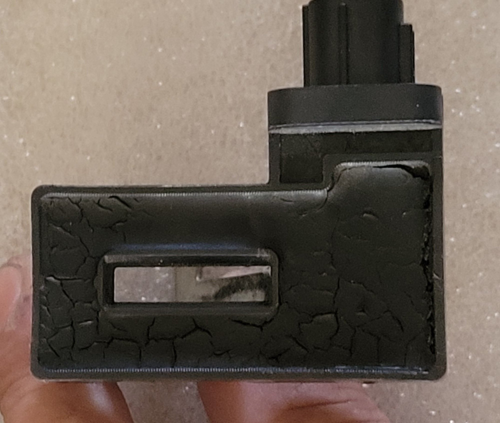

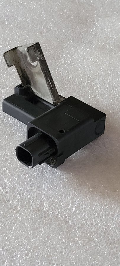

I have a 2016 Outlander Sport SE. Never had any issues with the vehicle until recently. After 4 Batteries, 2 alternators, 1 tow and tons of research, I found one part that isn't mentioned anywhere. It's hidden in plain sight and apparently the dealers and manufacturers don't want you to know. The part is called, " Battery Temperature/Voltage Sensor" and is literally on the Negative (-) battery cable. This part is responsible for communicating with the ECU to adjust charging and regulate Voltage. The sensor takes the condition of the battery (Temperature, Volts, Cranking Amps, and load) and increases/decreases the volts. When this part goes bad it will depleat the battery and drop Voltage fast damaging the battery. The dealer can order part but can take up to 3 weeks to arrive.
Note: I have a sound system installed and it could be the culprit of the failure due to amp draw/surge..
Hope this helps!
