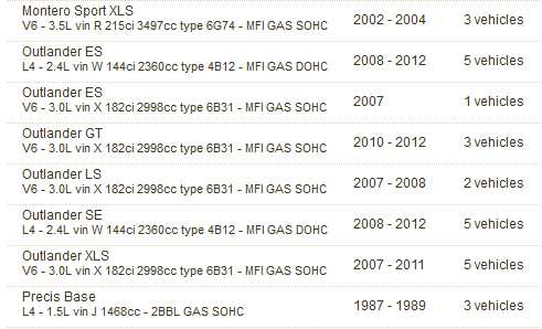

Today I had to buy an 1156 daytime running light for our 2010 Outlander XLS w HID.
The only difference between a regular old 1156 lamp and the Mit 1156 lamp [Mit. part no. MS820949; writing on lamp: Stanley 12V32CP(27W)LL] is that the regular lamp bulges out like a regular lamp does and the Mit 1156 is almost a cylinder with parallel sides.
Well, believe it or not the local dealer charged me $19.50 for one lamp! I could have bought a regular-shaped lamp for $5 at a parts store.
As far as I can tell, the two lamps' electrical specifications are identical. Will the inexpensive regular-shaped lamp fit as well as the Mit lamp? Anyone tried them?
Thanks.

Notice in the above specifications that the diameter of the glass is 1". My caliper tells me the Mit lamp is 3/4", so the glass on the standard lamp "poke's out" a mere 1/8" more than the Mit lamp on either side of the center line of the glass.
Therefore, as far as I can tell, Mitsubishi's Stanley 1156 12V32CP(27W)LL lamp is indentical in every way to the Sylvania 1156LL, except the shape and diameter of the glass "bulb" and, perhaps significantly, that little "hip" on the metal body of the OEM, as shown below:

Applicability of the Sylvania 1156LL for Outlander:
