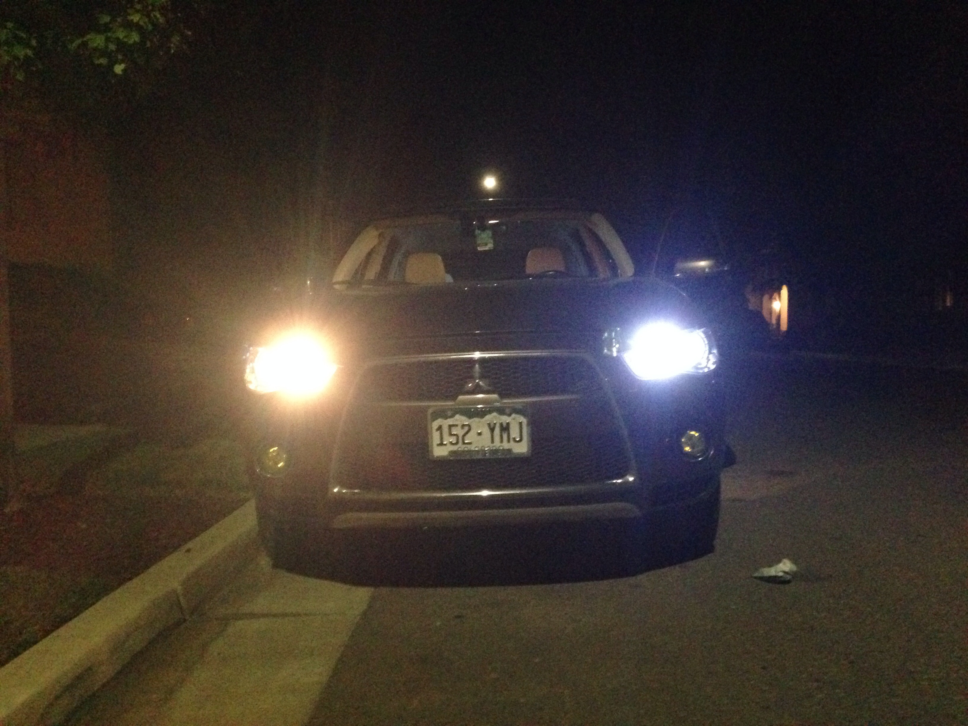

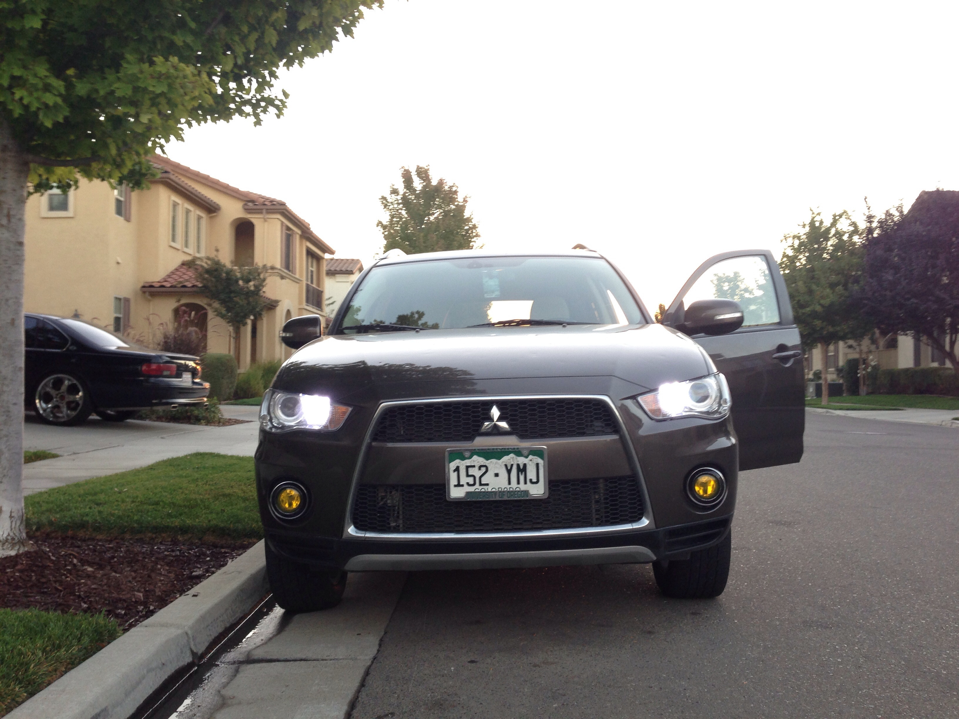

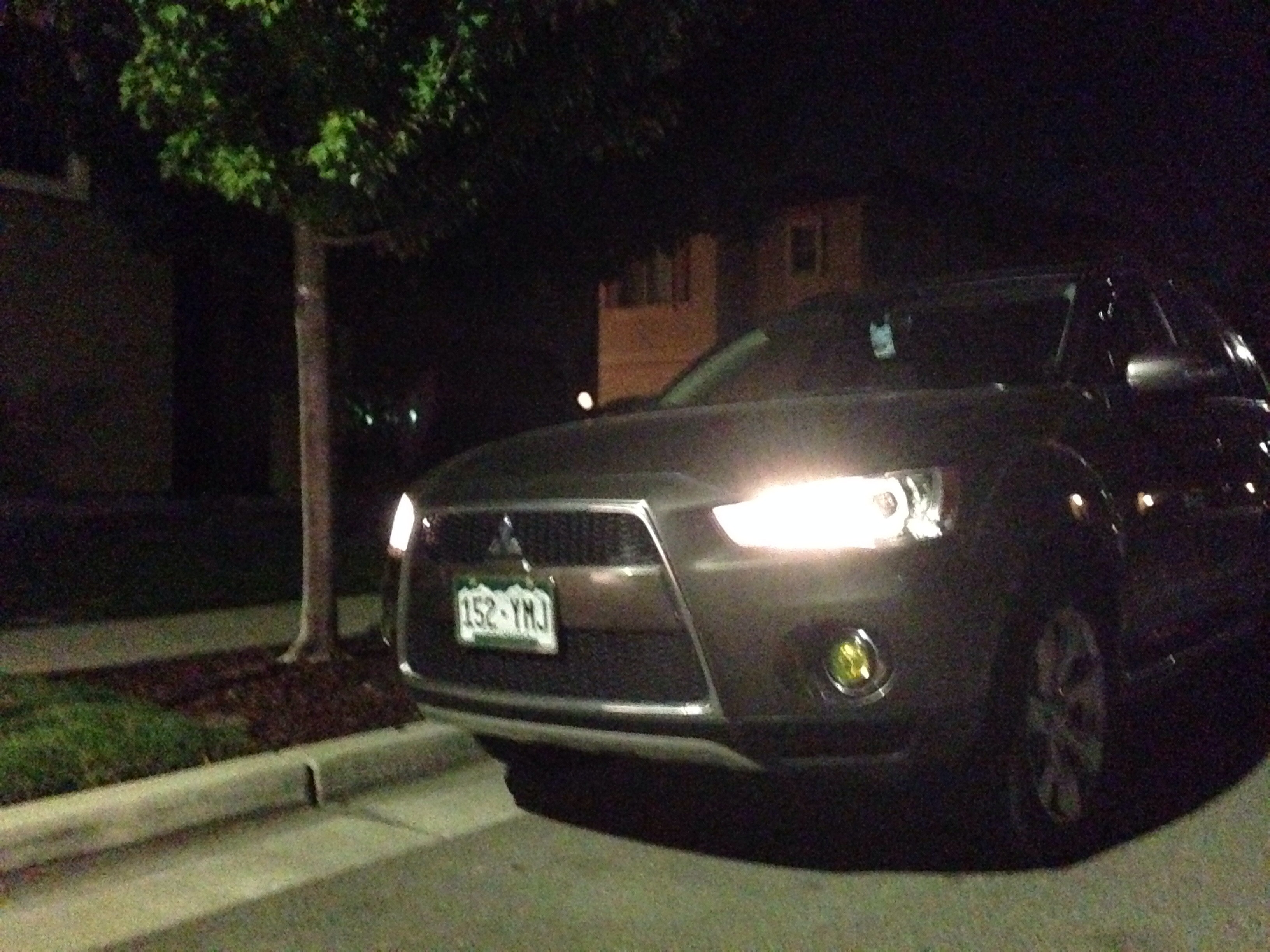

Hi all,
So I did the LED conversion on my DRL on my 2010 Outlander XLS V6 AWD.
In my honest opinion these LEDs are beautiful! Time will tell to their dependability, but I am very happy with first impressions.
Taking pics at night was challenging, but here's what I got so far:

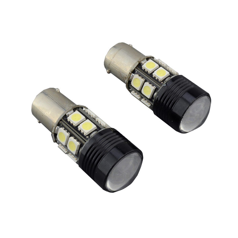

Newwer 27 SMD Projector LED 1156 Bulbs:
Before:
Affter:
Daytime:

ooh the lights are great no doubt about taht... the issue is the type of lighting they provide, you want flood style lighting for rev lights, the issue is with them as back up lights you can see the wall 30 yards behind your car clear as day but none of the area between you and that wall... was horrible for hooking up the trailer or even dumb **** like backing the car up the driveway.

Well, flood lighting depends on the reflective housing, right? So if installed in the reverse lights, you'd theoretically get a projection backward and the surrounding SMDs would reflect off the reflective housing, giving you your flood lighting.
Again, all in theory. I will try to get them installed in the reverse lights and report back.

no sir you are thinking old school bulbs, not LED hell CREE (best in the led game) sells flood and spot light leds so you can build your own set ups, same things they use in their light bars, i have done about 15 of these on my toys. the light deflection off the LED itself is completely different for flood as it is for projection, even with the 50/50's along the sides of the bulb you get almost zero flood style lighting, they are also 6k and that is not really what you want for that style of lighting. again if you just want the clean bright look these will do it, but i need the lighting for backing up and trailers and ****, i just could not roll with the look alone. They look bright as **** in the pictures, even the ones i snapped of them on in my truck where bright, but then you turn around and look there is nothing for a good 15-20 yards behind you then the area 20+ yards away is very well lit. great for driving ****ty for backing up
