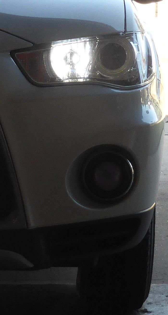

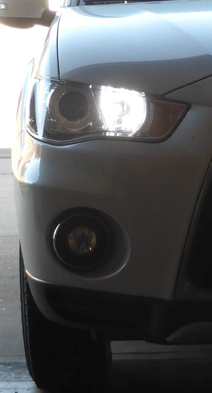

I'm resurrecting an old thread because I have just installed the following LEDs to replace the 1156s in our vehicle.
https://www.amazon.ca/Efoxcity-Brigh...B4RR52PKYAXQKC https://www.amazon.ca/Efoxcity-Brigh...B4RR52PKYAXQKC
The 1156 supposedly puts out about 450 lumens. The above supposedly puts out 650 lumens. As far as I can tell, the new LEDs are brighter than the 1156s and much whiter. In short, I love them.
When seeing them in person, the individual LEDs can be easily discerned on both the reflectors, and the LEDS of the central flat plateau of the LED lamp can also be discerned through the hole in the center of that little chromed "stand" into which the lamp is inserted.
In the photo that contains both lamps, the individual LEDs can be seen pretty well on the driver's side, at about the 7 o'clock to 9 o'clock edge of the light.
The long-life incandescents are rated at about 2,400 hours, while these LEDs are supposed to last 50,000. We'll see about that. I'd be happy if they lasted 5,000! Again, so far I'm very pleased with these LEDs. My wife raved about them. She said that they make the vehicle look like it is a newer model and I had to agree with her.
