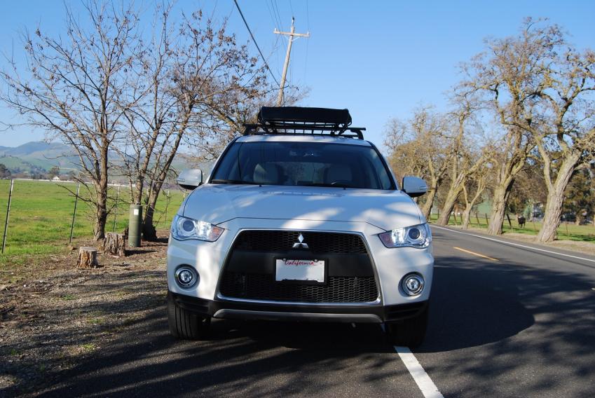

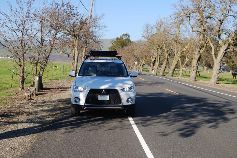

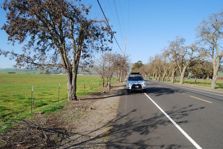

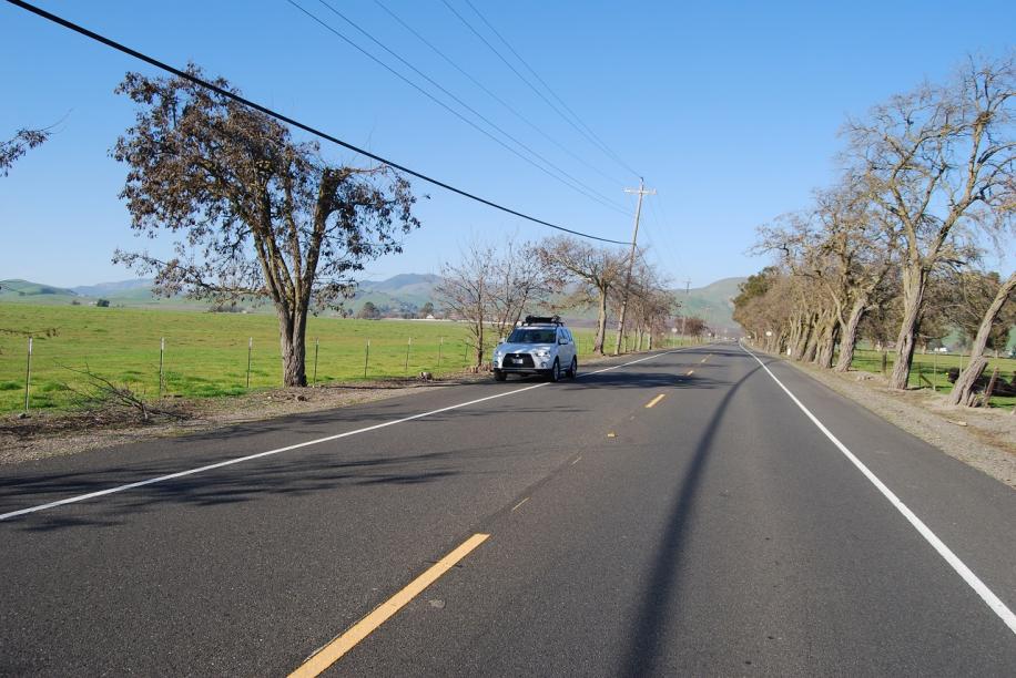

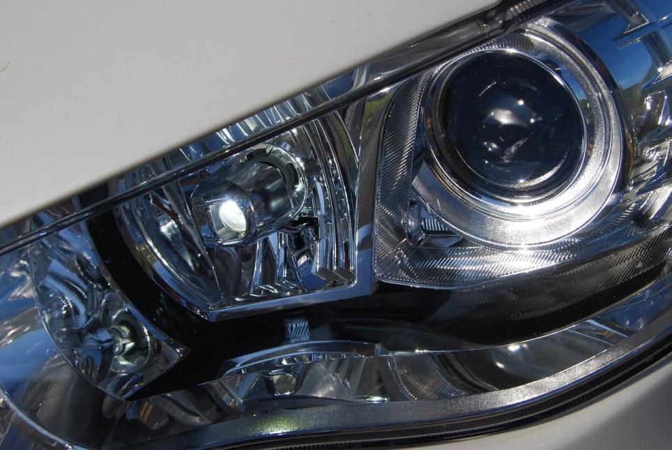

Ordered these from Amazon ($27)
The vendor is called Z8LED, they have a lot of unique bulb replacement stuff. These have 6x "CREE" SMD. Not sure authentic or not.. but very happy with the color and how the light distributes in the reflector housing.
I don't have to kneel down to see them on anymore.
I was able to see my DRLs reflected on the cars in front of me.
With the JDM one previously I was mostly not able to see my DRL reflection which tells me they are not very visible.
Here are some pics of them viewed from different angles. It gives the car an updated look and less strain on the power (stock 1156 draws 2.1amps and these less than 1 amp)
