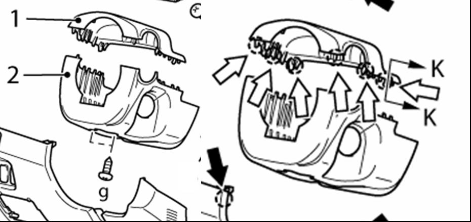

how do I remove the cover by the steering wheel in order to remove and install the stalk? Is there a simple diagram availble?

mightyOUTTIE, look here (https://mitsubishiforum.com/m_239989/tm.htm), maybe it can be of aid. Or:

so there are 2 screws and clips? Do I have to open up the vents too? seems complicated
