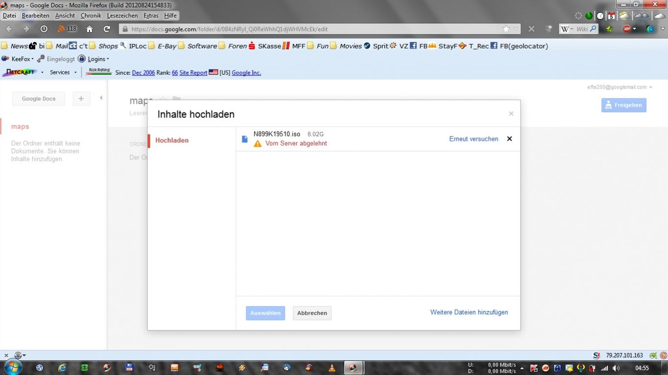

Hi Mase
I've uploaded the complete ISO to your Webspace, but it ends with an error.
view attachment.
Old Aug 30, 2012 | 10:48 PM
  #1250
M.a.S.e's Avatar
Joined: Aug 2012
Posts: 22
Originally Posted by eigi01
Hi Mase
view attachment.
i see....
ok, what is your email address, i will give you a location (different provider)
PS - i see the language of your image is German.
which maps are you uploading? for US maps? do you know the part number?
