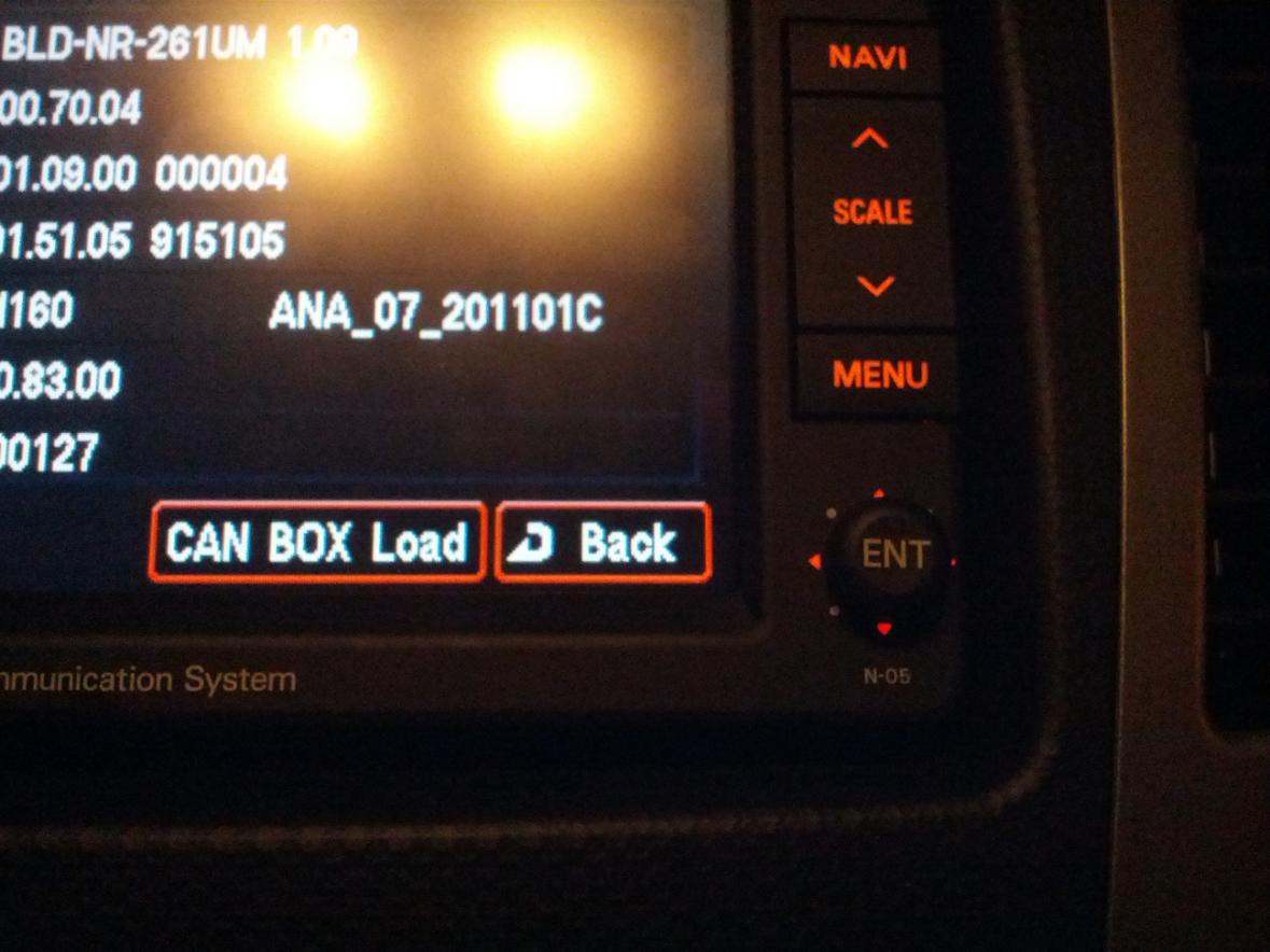

Hi guys....I have attached screenshots of my MMCS version.
Will the latest NavHack work for me? I have the N-05 unit. I know I can try first to see but I don't have any CD-Rs at the moment so decided to ask first!
Also you can see my MAP version in 2 of the screenshots. One says 2010A and the other M160 201101C.
Btw I have the 2012 XLS built in January 2012.
Map is from first quart of 2010 by Navteq, then Mitsubishi release is from first quart of 2011
We have similiar european maps
