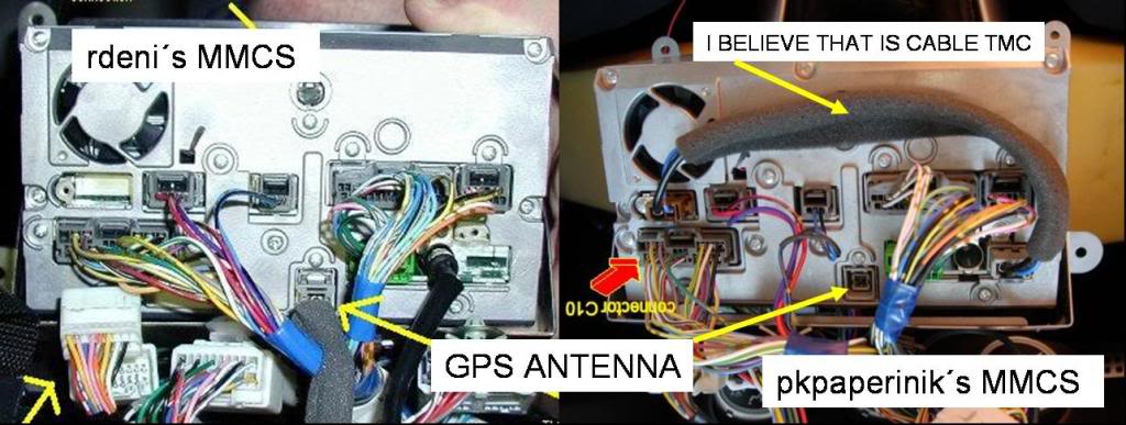

@jsrd: Let's continue the discussion here. Do you know the socket # where Connector 6 (TMC cable) goes into? does it connect to the MMCS directly?

0k rcpax, we continued here. I don't know about tne socket 6 in our MMCS, we needed the aid friends who has these functions, so they confirm it; but, maybe possible. . .

rcpax, reading through forum, I took this information, I don´t if is correct, but is a reference. . .
Old Dec 21, 2008 | 02:25 PM
madmex's Avatar
Joined: Jul 2007
Posts: 13
Default RE: Enable TMC and RDS reception in US MMCS?
@jsrd
that´s right,it is the european tmc cable.
greets madmex

Thank's madmex for your response. Now, we must determine f it is necessary "turn-on" the function since it did rdenis with the camera of reversa, or if once connected the TMC antenna automatically activates, whenever we have the ports for cable TMC, ready for connection in our MMCS. . .
