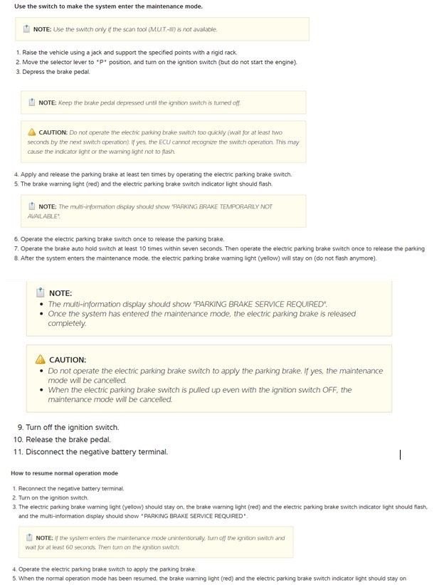

Hi all,
You need to enter the vehicle into maintenance mode.
It can be done with the MUT - III scan tool, or manually by utilising the park brake switch.
Refer to below to use the park brake switch to enter maintenance mode

Hi everyone,
I am struggling with this issue as well on my 2017 outlander gt awc. I follow all of the steps manually and when I go to push the calipers piston back in, it won’t budge. I have tried many times, with different configurations with the switch. I can get the display to read that the “parking brake is temporarily out of service”, yet my piston still won’t go in.
I’d rather not take it in to the dealer to be serviced for a rear brake pad change. But I’m at my wits end here.

Originally Posted by Dr. Brown
Hi everyone,
I ended up removing the actuators and spinning them back with a torx bit. Clockwise releases it. I put the pads on and drove it to the dealer. 100 for them to reset them with the mut. Cheaper than paying 1k for a scan tool that retracts them.
