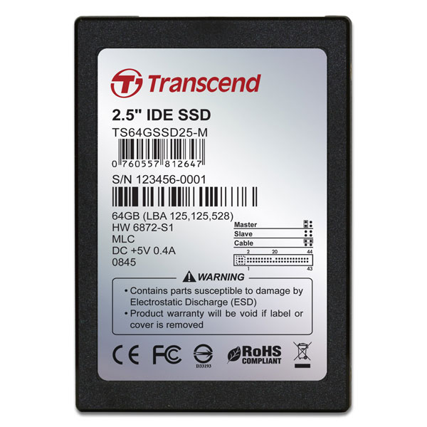

Ok I will try it by myself and I willalso try to put the map update that has been posted a few days ago.
I will use this ssd (Transcend 64GB SSD (2.5", IDE, MLC, TS64GSSD25-M)
This is a cheap ssd although the MLC chip based SSD are not qualified for heavy (industrial) use. According to it's specs it sems to fail short to the temperature oparating limits starting from 0-70C while the HDD included in the MMCS seems to oparate from -20 to +70C. MLC SDD drives seem also to have a LIMITED READ/WRITE LIFE EXPECTANCY...
(Anyway the original disk will remain stored at home without ANY modifications...)
