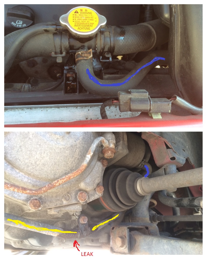

Hi, 2007 XLS here. Does anyone know how I can find the part number or name of this metal coolant line? All web diagrams just give generic diagrams that are ambiguous. It has developed a leak from corrosion right at the clamp under the driver's side axle. It connects to the rubber hoses marked in blue. Thanks in advance.
[9/11/2016 update] Went to the stealership and got part # 2922A239 almost $90 for this metal hose.
