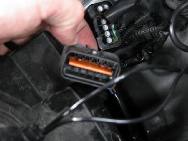

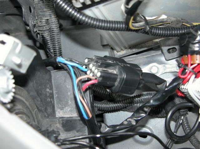

2. Disconnect large connectors going to head light assembly on both passenger's and driver's sides. (see connector.jpg - notice that I took this picture after I already switched the wires!!!)
3. Slide the "mother side" forward to remove from the head light assembly (see inside.jpg)

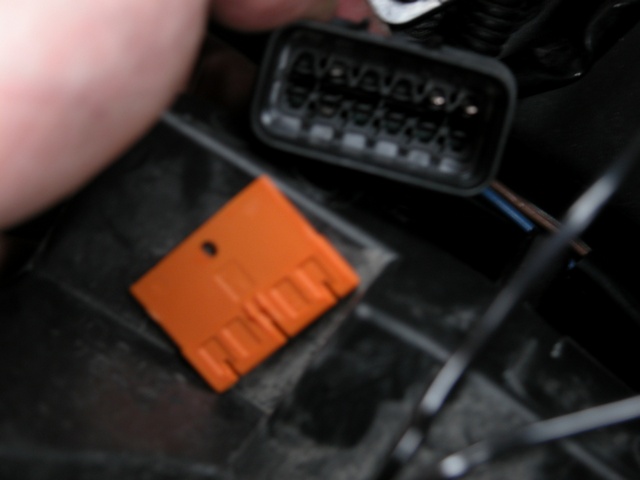

4. Pull the orange pin separator/holder out of connector (see removed.jpg)
5. Now you can easily switch the RED (low beam) and the BLUE(parking light) wires. Just use small screwdriver to release the pins from inside and pull them back. Switch their places, push them back into the connector and put orange holder back.
6. Connect large connectors back together. Voila! You can turn/on your low beam HID lights and have your DRL on.
