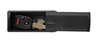

Attach this to some steel under the car. With the magnets you can pull it off and on as needed without spending too much time in awkward positions
Amazon.com: Master Lock 207D Large Magnetic Keycase: Home Improvement Amazon.com: Master Lock 207D Large Magnetic Keycase: Home Improvement
