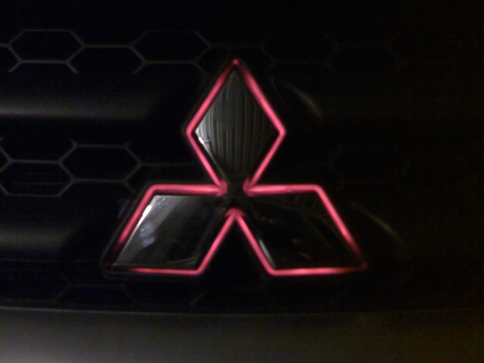

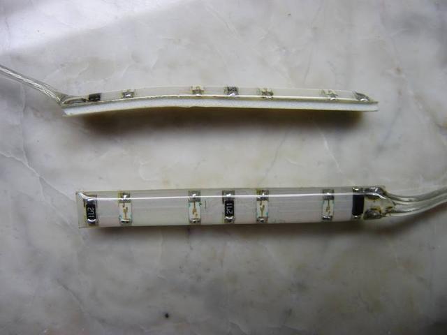

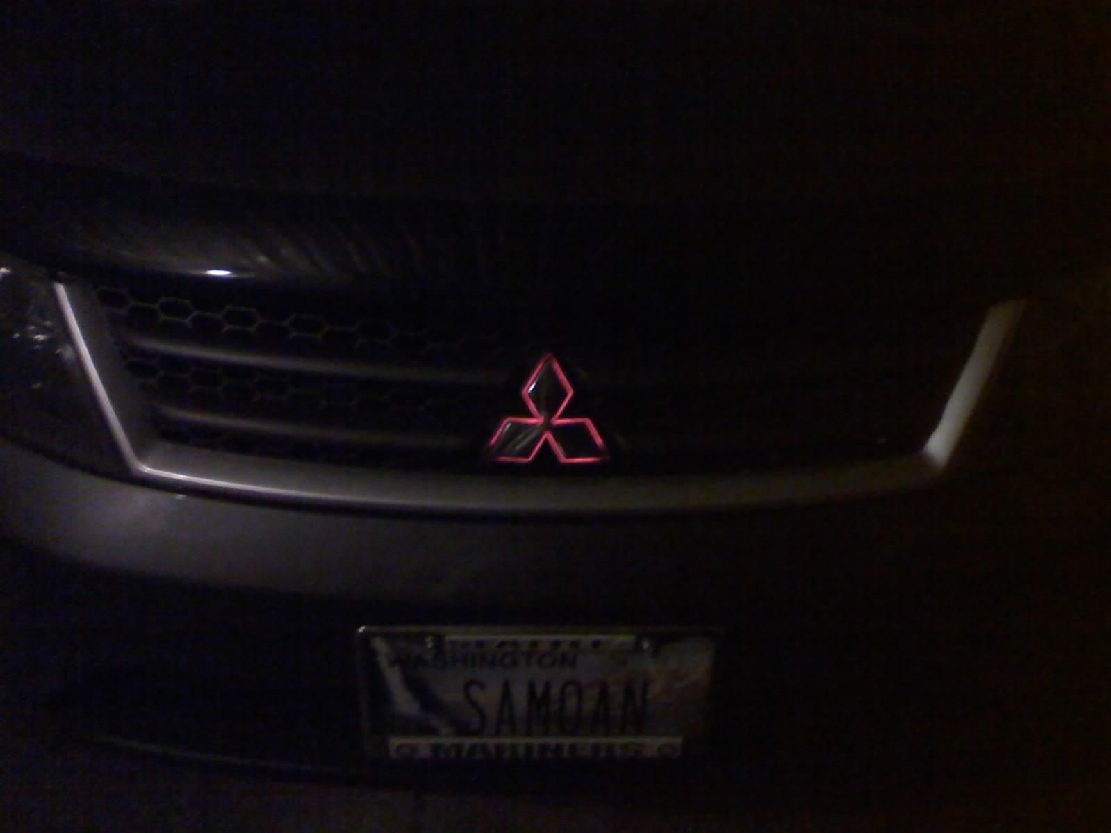

Old Sep 15, 2010 | 02:29 PM
  #26
tfaas's Avatar
Joined: Nov 2009
Posts: 41
Originally Posted by White Out 2010
Hey tfaas, thats pretty cool the way you backlit your emblem. Show us or tell us how you did it so we may do it in our cars as well.
I used three 4.5 mm smd led strip I bought off eBay. I pryed off the badge, which is held on with some kind off putty type adhesive, drilled a hole where the three diamonds meet and put one strip under where each of the diamonds sit. I ran the wires throught the hole I drilled to a piggy back fuse i put in the under dash fuse block. Then I super glued the badge to the led strips. I aslo put in bullet connectors so if I ever have to remove the grill I don't have to cut the wires. I wanted to use white, but I already had red ones.
