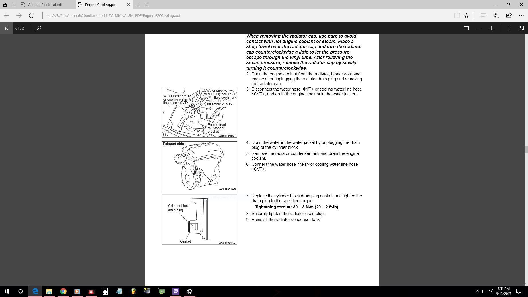

Where is the radiator drain plug for 1st generation 2012 Outlander sport?
I think i have to remove some plastic cover help by the flimsy plastic rivets.
Thanks,
