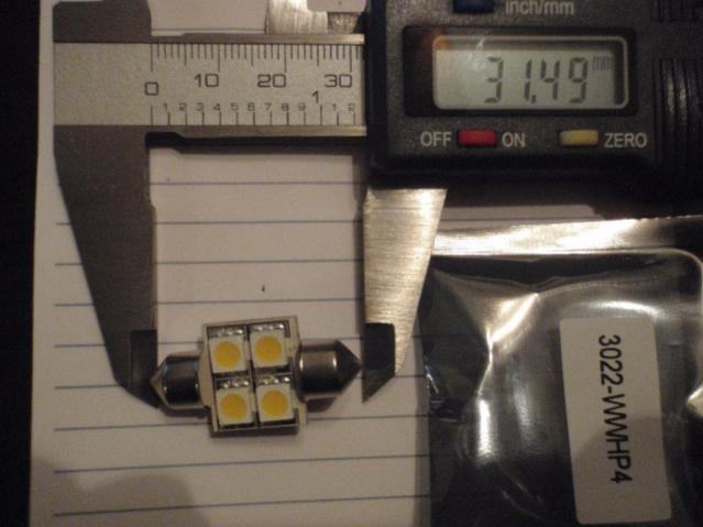

The two dome lights I replaced with 3022-WWHP4 bulbs which are higher powered. I decided I didn't need the high power bulbs staring me in the face when I get in the car or have to read a map but they would definitely help with the trunk.
The problem is the HP bulbs are easily a millimetre or more larger and are really snug to get in - the regular powered bulbs are a match to the OEM size.

About 2.5mm longer than the OEM bulb I took out which was about 29mm in length from tip to tip.
