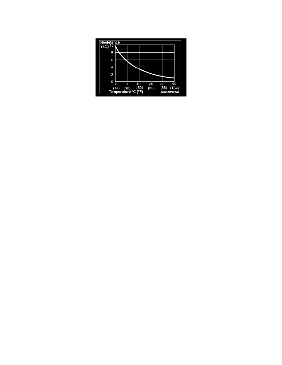

I wonder if adding a resistor inline with the ambient temp sensor would work. The higher the resistance, the colder the truck thinks it is. Although the instrument cluster would read a colder value than reality, it might be enough to fool the ECM into increasing the idle.
"This Technical Service Bulletin advises the steps to reprogram the ECM with new parameters which will allow the engine idle to be increased when
temperatures are below approximately +5°F (-15°C)."

My suggestion is for cars that have already had the ecm update completed. Mitsubishi programmed the ecm to increase idle at ridiculously low temperatures (see above). It's unrealistic and that's why people with the "update" are still complaining.
Since the coolant temp sensor can't tell what the ambient air temperature is, I'd be interested in hearing what potential problems you might be referring to.
