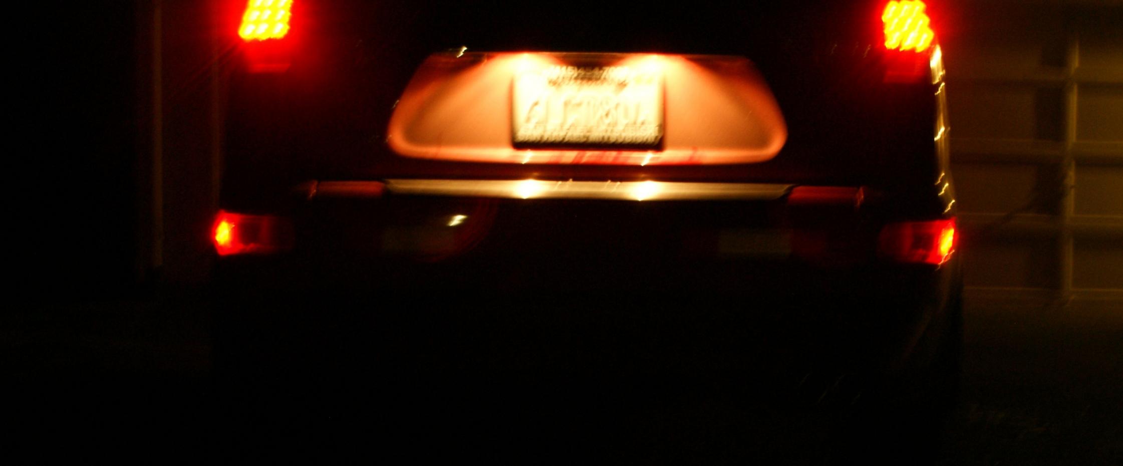

Default Outlander rear fog light a success
Photo shows the Outlander rear fog light ON. Amber color is bright red in practice.

Old Feb 7, 2010 | 07:37 PM
  #46
batman47's Avatar
Joined: Jan 2008
Posts: 69
Photo shows the Outlander side marker light ON. Amber color is bright red in practice. Rear fog light when ON side marker is also ON.
Attached Thumbnails  Rear fog lights/lamp-side-marker-01394.jpg
