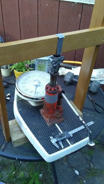

For future searchers, there's basically no way to check this. To measure the plunger height at different pressures I first tried this set up:

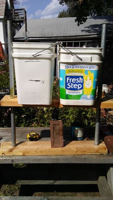

and found the force exherted by the plunger depended a lot on how fast you compressed it, then would slowly leak down. So I tried applying a constant force with this set up:
11lbs of water in each bucket. Hard to see, but the tensioner is on top of the brick, to give me room to measure the plunger extension. Even with only 22 lbs pressure on a brand new tensioner, it will sink down over 10 minutes to under the .45" called out.
So, I just said the hell with it, bleed it several times and installed it. It is what it is. Wish me luck.
