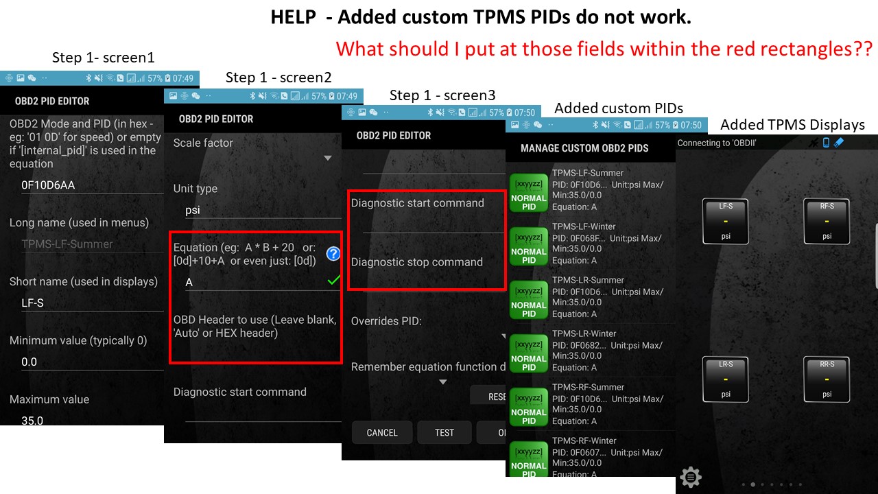

I recently got a OBDII with an expectation to see the tire pressures in each of the 4 tires. I can connect to the OBDII very easily and see many sensors, but not the sensors for the TPMS. I have tried those EX and LX Mitsubishi plugins in Torque Pro, but still do not see TPMS sensors.
I even tried to added the PIDs my garage scanned when swapping tires, but Torque Pro read out 0. Not sure if this is because I did not put in the proper header and equations.
Does anyone here have the PIDs for the TPMS on 2016 Outlander GT? In case it helps, here is the OBDII that I have https://www.aliexpress.com/item/XTRO...311.0.0.npYQg8.
Thanks in advance.

Attached Photo shows what I did to add custom PIDs, but they do not work, could experts here point out what I did wrong?
1. are the tire IDs the correct PIDs I should put in at Step1- screen1?
2. what should I put in for the equations and the Header fields at Step 1- Screen2?
3. what should I put in at the commands fields at step1- screen3?
Thx
