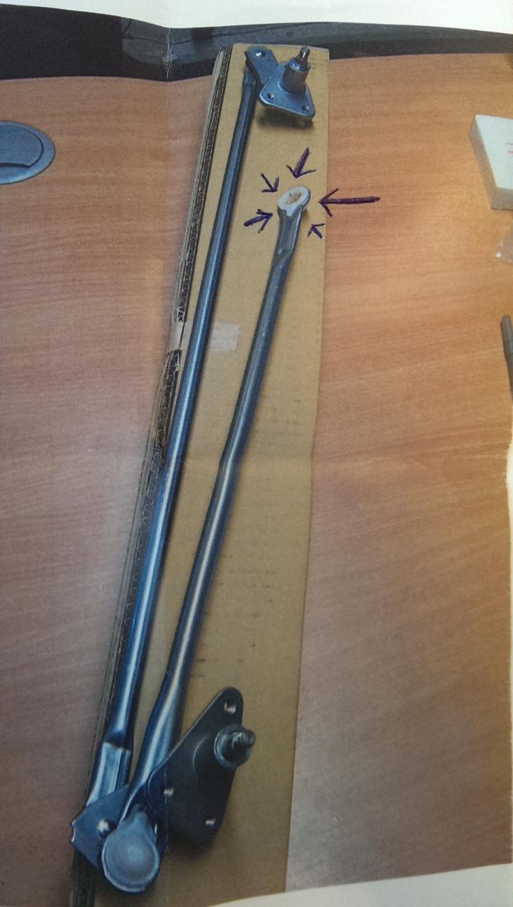

Hi!
I have a 2007 Outlander Instyle 2.0D.
At the weekend I had some snow on the roof of my car, which I failed to clear and that resulted in a damaged wiper linkage (not a huge amount of snow but it turned out to be wet, heavy snow so lesson learnt)
I have found the part to be a small white plastic clip which has snapped. Its the plastic part that connects the linkage to the motor (I think thats best how to describe it but please see photo)
I can see there are other 'bushes' for other cars on ebay and other sites... does anyone know where I can buy this as a stand alone part?
Thanks for any help/advice in advance
Adam

It cost me $210 for the wiper linkage and $90 for labour.
Hi,
Thanks for the reply.
My dealer said the same at first but I made a fuss about spending so much money (it costs 350USD in norway) so he recomended a part for a Mitsubishi Colt (part number MB046360) and said with some small modifacation it would fit.
I couldnt find this part number in europe, only in the states so I made a solution last night.
I removed all the plastic that was snapped and put the linkage over the moving part then fitted a very strong metal clip to hold it in place and a couple of cable ties to keep that in position. (sounds bad but it was super strong)
A bit of grease later and its not only working but appears stronger than the original... cost me 2USD... I know its a bush fix but I think it will last for years.
Peace!

Here is a photo to show exactly what I did
and fyi I put some silican tubing inbetween the metal linkage and the metal moving ****... so its not metal on metal and so there is a smooth movement

Nice job! Thanks for sharing the picture.
Dealing with this myself. Nice fix. I can't believe this part is so hard to find. Still looking. Got a mixed pack of bushings from auto store and they're all too small.
