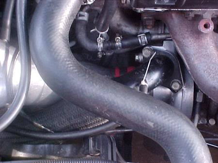

Mechanic still says pipe is wrong, I dont know why. What a nightmare.
I dont want to have the car towed all the way up here. Can anyone confirm that the pipe he has is in fact the correct one???
I enclose pictures
[IMG]local://upfiles/15235/49F8DD021FEC4778B834A8F4AA05FCB8.jpg[/IMG]
[IMG]local://upfiles/15235/F33A8545F06C45EEBD97B9DB7E8C371D.jpg[/IMG]
[IMG]local://upfiles/15235/A4E5D4D79EBE41C0807ADB126F59E6B8.jpg[/IMG]
Old Dec 7, 2007 | 12:21 PM
Default RE: help me please, newbee
It has aleady been confirmed that this engine is in fact a 7-bolt. My guess is now that we he has is from a 93-94 eclipse turbo. And that he has a stock 14b. Now in saying that its a 14b that means that YES the j-pipe will work. Unless your missing an IC pipe it will work. Which there is no way your missing one. So this j pipe will. I really dont understand at all what this guys problem is. Here is another picture that shows you what your supposed to do with the stock intercooler pipe
