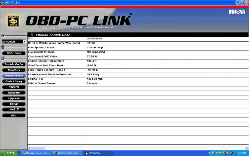

sorry fellas....its a 97 mirage. also the latest news is now it is showing a 0170 code which is the "fuel trim-bank 1". so this is now the priority code. the 0120 code stop showing after the TP switch was replaced. ....also no i havent tried to clean the maf.....will try that.

the fuel trim bank one issue could be caused by the maf. this is a 4 cycl right so there is only one bank, which means you are either running rich or lean. could be caused by o2 sensor or maf, usually its the o2 sensor. but usually that wont make the car idle wierd or shut off on decel, that sounds more like the maf, like i said i would take it to an autozone and see if they can test it.
yes it is a 4 cylinder ...very good info....will get the maf tested,....i think the owner already has a new o2 sensor but never had it installed. Thanks...glad i joined this site.

try cleaning it first, that may be it. or actually when was the last time the air filter was replaced, it could be as simple as that. the air filter is so clogged that it isnt getting any air. then if cleaning it doesnt work and the air filter is good then try getting it tested
