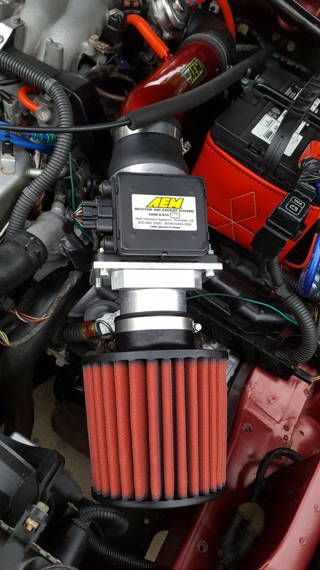

If you look at the pictures I have posted you will see a problem I created when Installing my AEM Cold Air Intake . The filter is open to the hot air off the engine . To overcome this problem I made a plate that fastens to my frame rail , a flex hose from Spectra and in the picture you can see I took the filter out of the engine bay and placed it into the fender well where it will get all the cold air it needs.
Just Hot AIr....
Relocation for Cold Air ..
