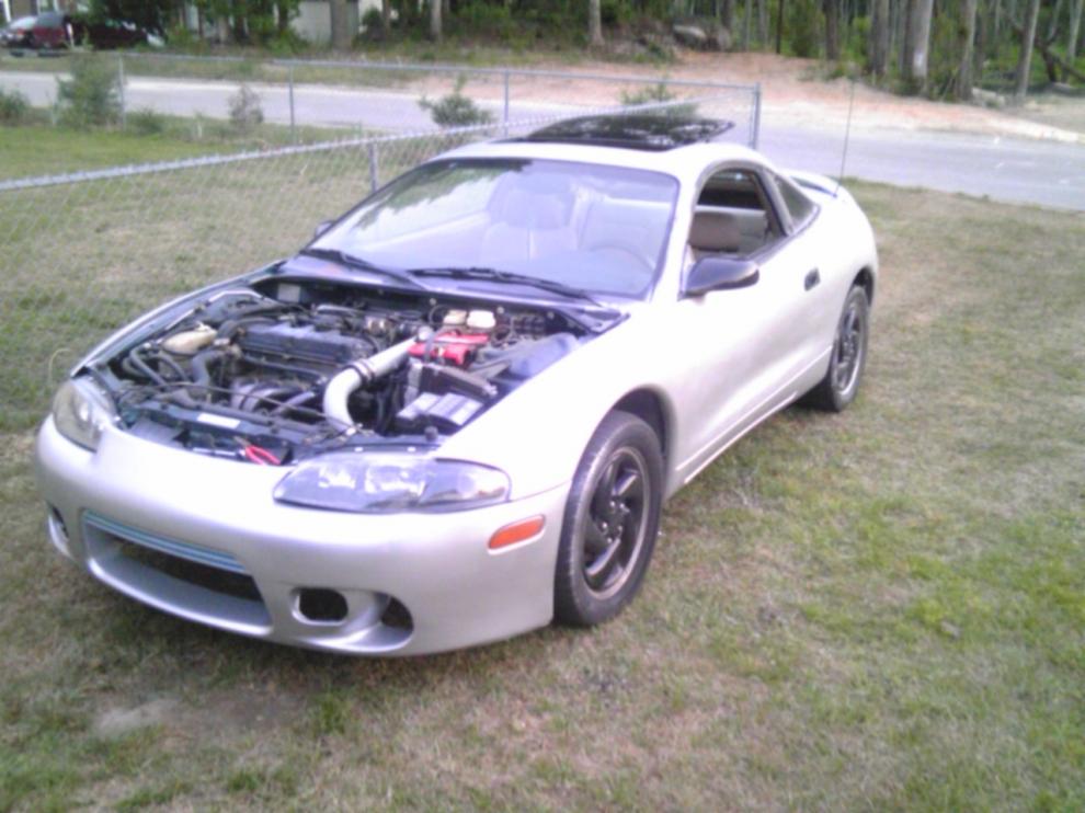

i wanna do a transmission swap to a 5 speed manual in my 99 eclipse and what all will i need to do the swap and i mean everything plz help me with this the sooner i get the info on what i need the sooner i get everything i may need to put the tranny in
