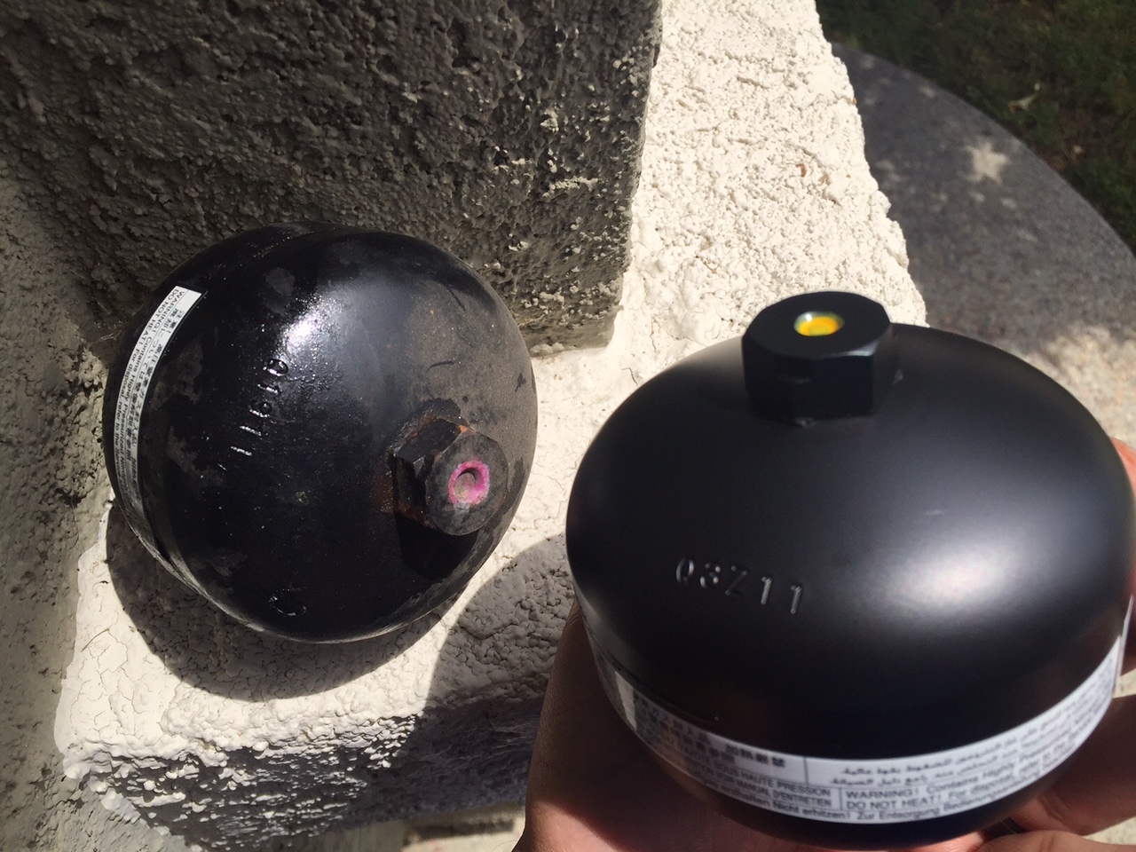

Here is a picture of my old one and the new one. The old one has the PINK top (came with my 2002 Montero--I was not part of the recall) and the one with YELLOW top is the one I just bought.

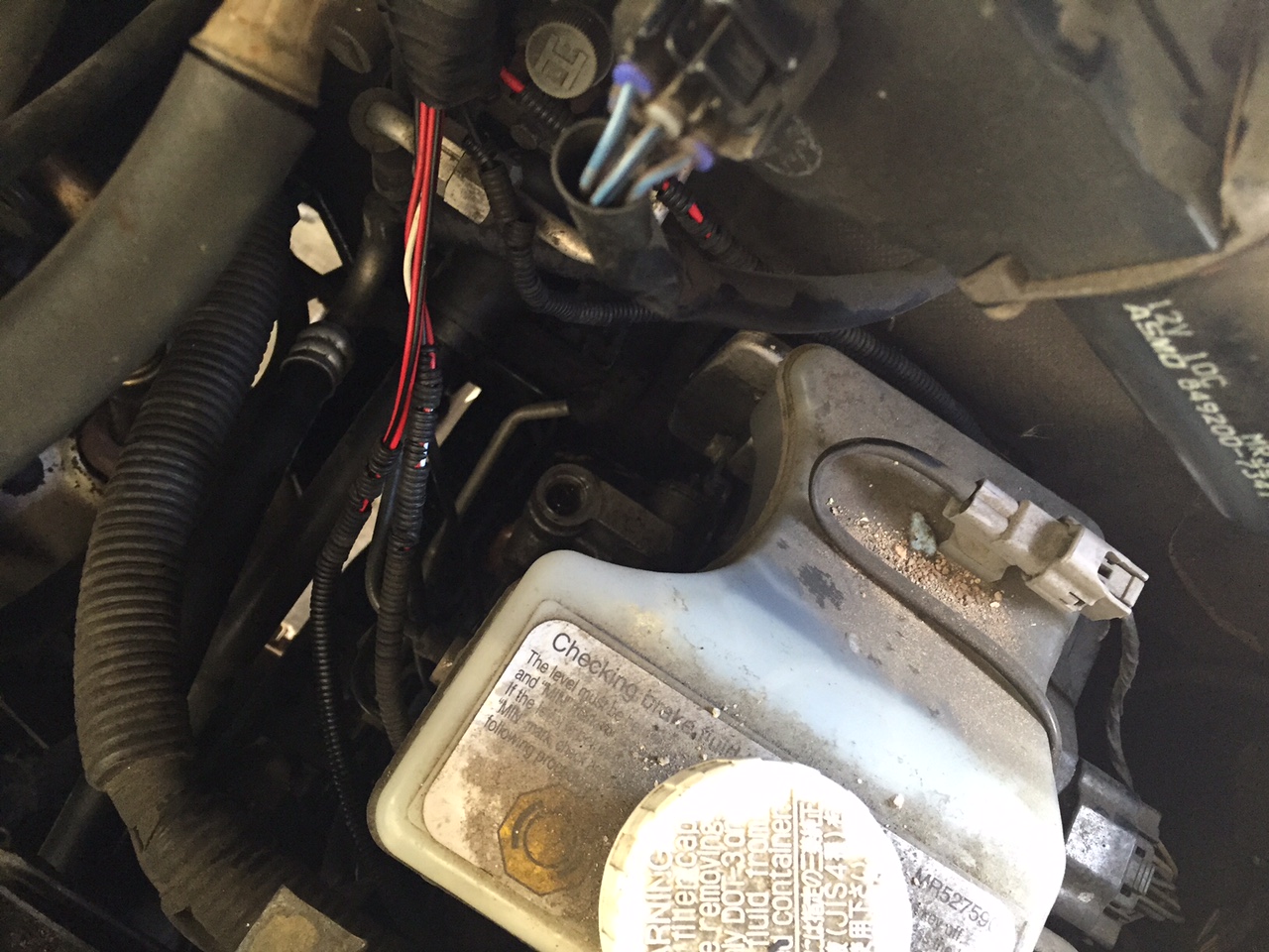

and obviously here is a top view of the old accumulator removed ready for the new one to screw right in
The new accumulator already came with a new o-ring preinstalled. Some posts I read before made it seem like it didn't, but mine did.

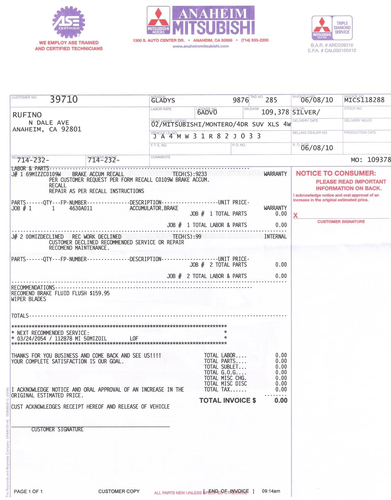

And just as a reference, here is someone's receipt (not mine) who got theirs done under recall. You will see the part # listed there again. Just more incase someone may find it useful
