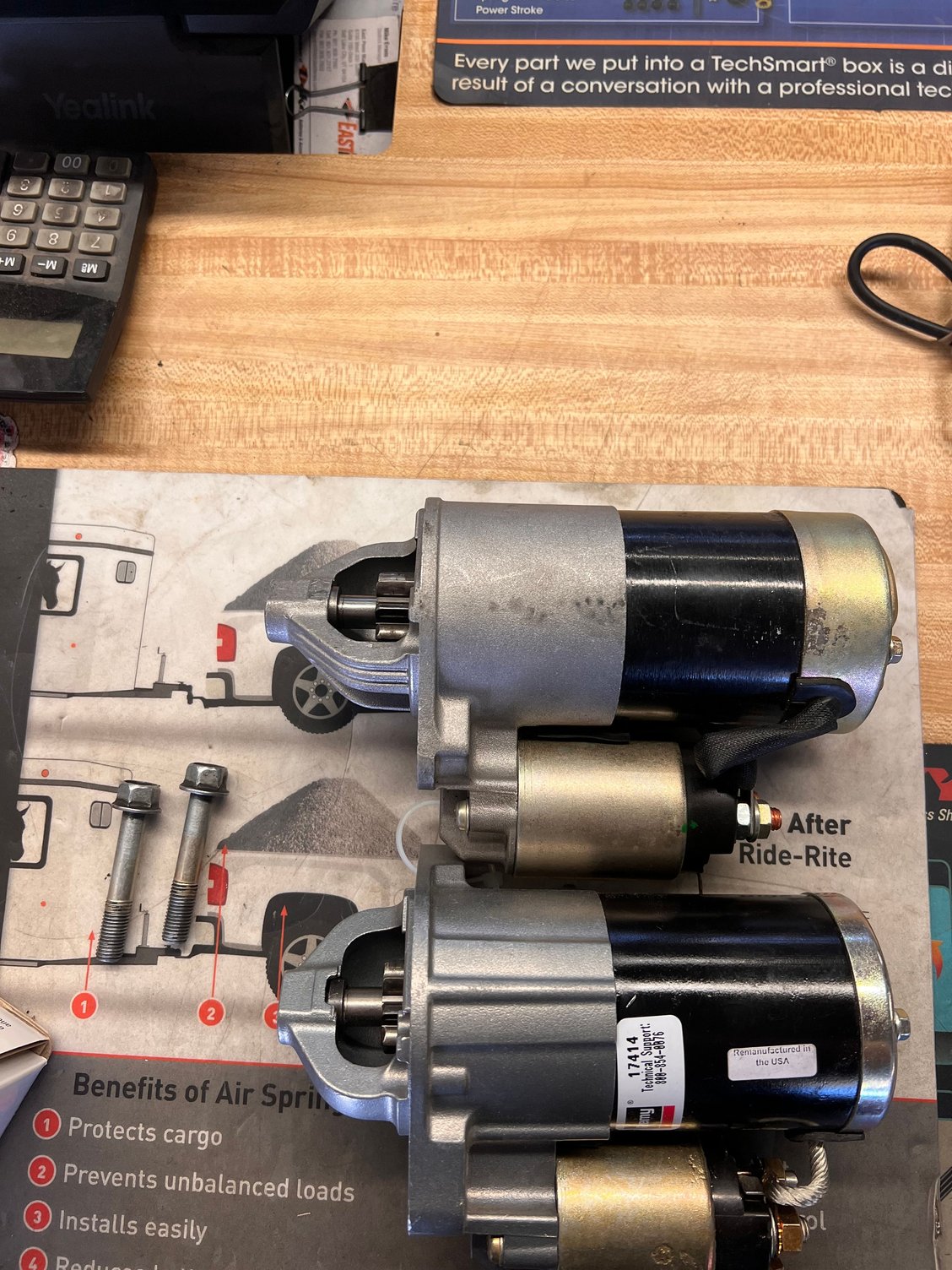

Old Jul 19, 2023 | 05:34 PM
BKCaspy95's Avatar
Joined: Oct 2022
Posts: 11
From: Idaho Falls, Idaho
Default Update
I finally got the correct starter and can now start putting it back together. I’ll include the picture of the 2 Montero starters next to each other to see the differences. It’s wild that it took so long to get my hands on the right one 😅
