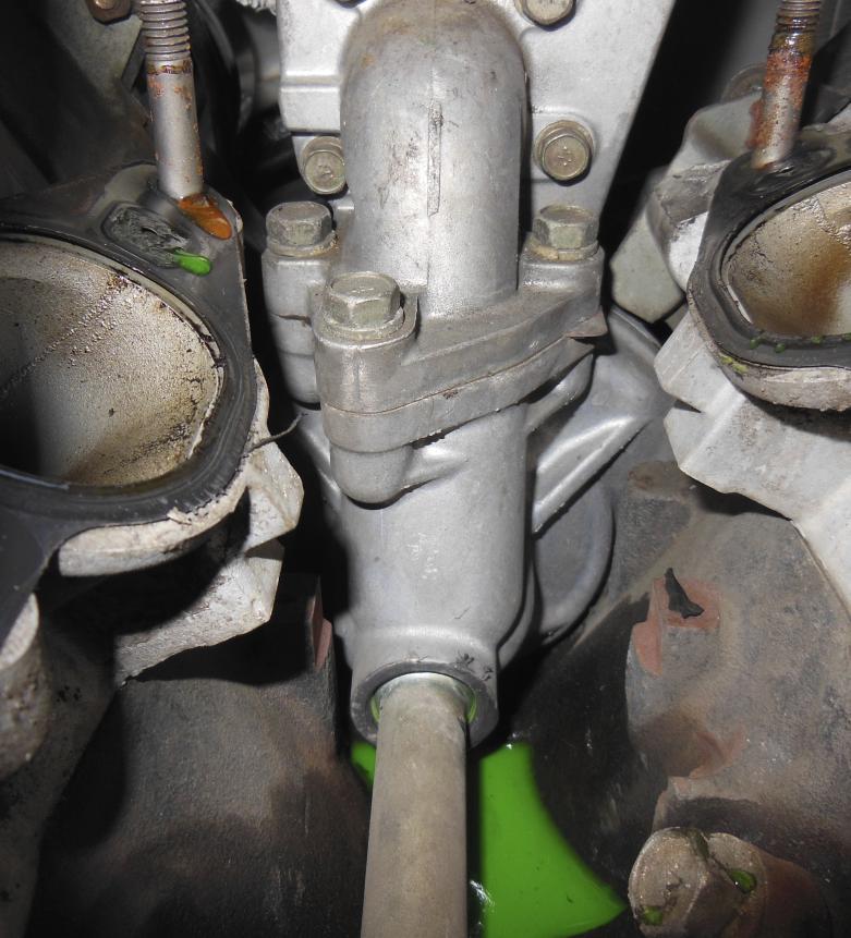

Last week I picked up a 2001 Montero Limited - a mechanics special on craigslist. It had a significant coolant leak, collecting in the valley between the heads. Also, when the brakes were applied, there was this chirping noise coming from the ABS accumulator. The car had just had head gaskets, timing belt, water pump, plugs, and a lot of other work done within the last 3,000 miles. I picked it up for $2,600, figuring it was either going to be one hell of a great deal - or a really bad one.
I joined this list, and started reading. I found that the coolant leak was likely the O-ring on the water inlet tube that runs in between the heads. I ordered a new tube, O-ring, manifold gasket set, and a knock sensor (decided to install one while I had it opened up). I also ordered a brake booster accumulator.
As I waited for the parts, I began to dismantle. After removing the lower part of the manifold I found that the knock sensor was fried (see photo) - glad I decided to order that part! I then checked out the coolant pipe, and I can see the coolant dripping from it, and could feel coolant on my finger when I ran it under the pipe (see photo). No leaking from the head gaskets - so things are looking good.

I replaced the coolant pipe, and put everything back together. Car fired up like a champ, brakes work great, and no codes!
Looks like a success!
