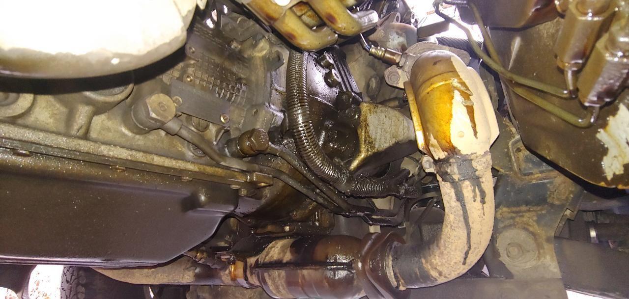

For some reason I couldn't upload a photo from PC. Here is what the bottom of my Monty looks. As you can see, engine is pretty clean, but anything after bell housing is a total oily mess. Exxon Valdez would be proud

I too would be inclined to pull the engine. You will have better access for other leak repairs.
I would think engine removal would be quite similar to the Sport which I posted details on. Use the factory engine pick points to balance the engine with your leveler.
In all honesty, removing the converter bolts was the hardest part of the job to get the engine out. Access sucked. Use new bolts going back in as I am sure you will damage the corners during removal as I did.
Lack of metal in the oil is a very good thing!
