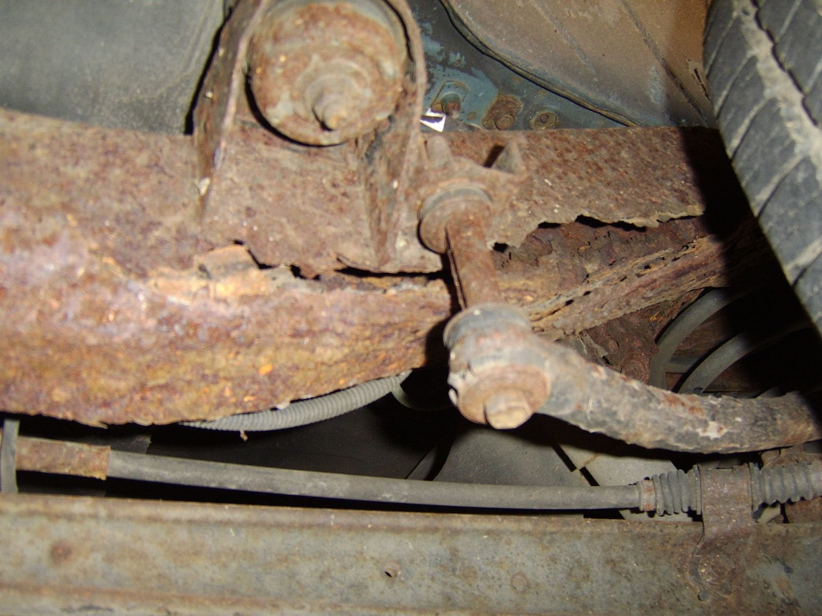

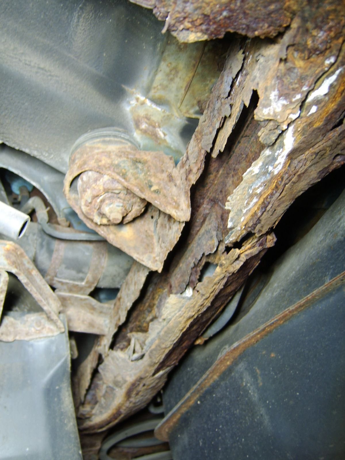

Hunter.....you are so right, that ole Monty better give you another good stomping of at least 250k miles. Since you have the knack for solving all Mitsu issues, now tell me how to snap my fingers and make a rusty frame on one of my Montero's become solid and strong again.
Here she is, a rare 5 speed:
She looks great on the outside, but lift up here skirt and it gets scarey:
Bet these pics make you appreciate your oil-soaked frame on your Monty.

Dang, that's some serious rust. I think your PO used Acme "Frame-be-gone" on it few times or something like that.
If the rest of the frame is like that, I think that specific frame much be beyond saving. Two approaches come to mind:
1. The easiest and likely the best option is to find old (internally destroyed) Montero amd quite literally - swap frames. The problem is - knowing you, you'll fall in love with it and keep it too... How about putting a call out to several junk yards that part cars? Tell them you're looking for a frame. They might be able to locate one somewhere not too far away. Heck, even if it's out west here (your best bet for non-rustu one), road trip it to bring it home. Then just set the body on it. The only thing you have to confirm ahead of time is if multiple years used the same frame design/shape.
Option 2 - pull the body and make a new frame from scratch. There are places that can do this, but that's $$$. Likely that will cost more than trying to find a donor frame.
Option 3 - (along the way of option 1), do you suppose old Mitsubishi pickups used the same or similar frame with Montero?
Of all these, I think a direct frame swap is best option. Even if you have to make/modify some ctossmember, it is still going to be the closest thing to the original.

Hunter......Yep, those are the options, none of which is a "simple job". I watched a video of a mechanic doing a frame swap on a Toyota 4x4, and I think his total hours were over 100, and he does this all the time, and has huge floor lifts. In the case of this rusty Montero, the worse rust is right around the rear axle and behind......so, I had been thinking about attempting to weld new "L" pieces of metal around the old frame. Another idea is just replacing the back half of the frame with a doner......that would be alot easier (I think) than replacing the entire frame. I will have to decide at that point in time when I have the time for that project.
Funny about what you said......I will find a "doner" Monty to steal the good frame, and not want to tear into it, but save it also. Its hard to sacrifice a decent set of wheels.....yep, my pop grew up in the Great Depression and passed down alot of his "saving" mentality. (He is almost 100 yrs old, and is like that Timex watch......takes a lickin, but keeps on tickin.)
Regarding buying a used frame from a salvage yard, I think I can find an old Monty with a good frame for about the same price as just getting a frame.....plus, I will have a ton of parts to boot. I think the same frame was used on these Monteros from 1991 - 1999, but I would have to confirm that. I think all the Mitsu. trucks used smaller frames, and not as hefty....but I could be wrong.
