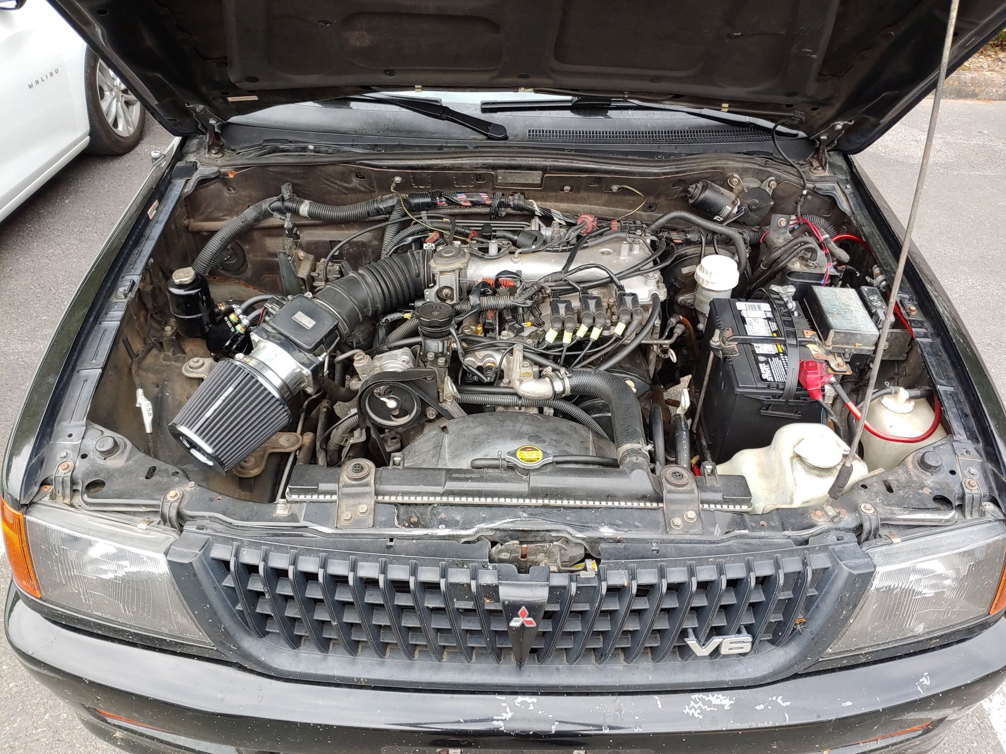

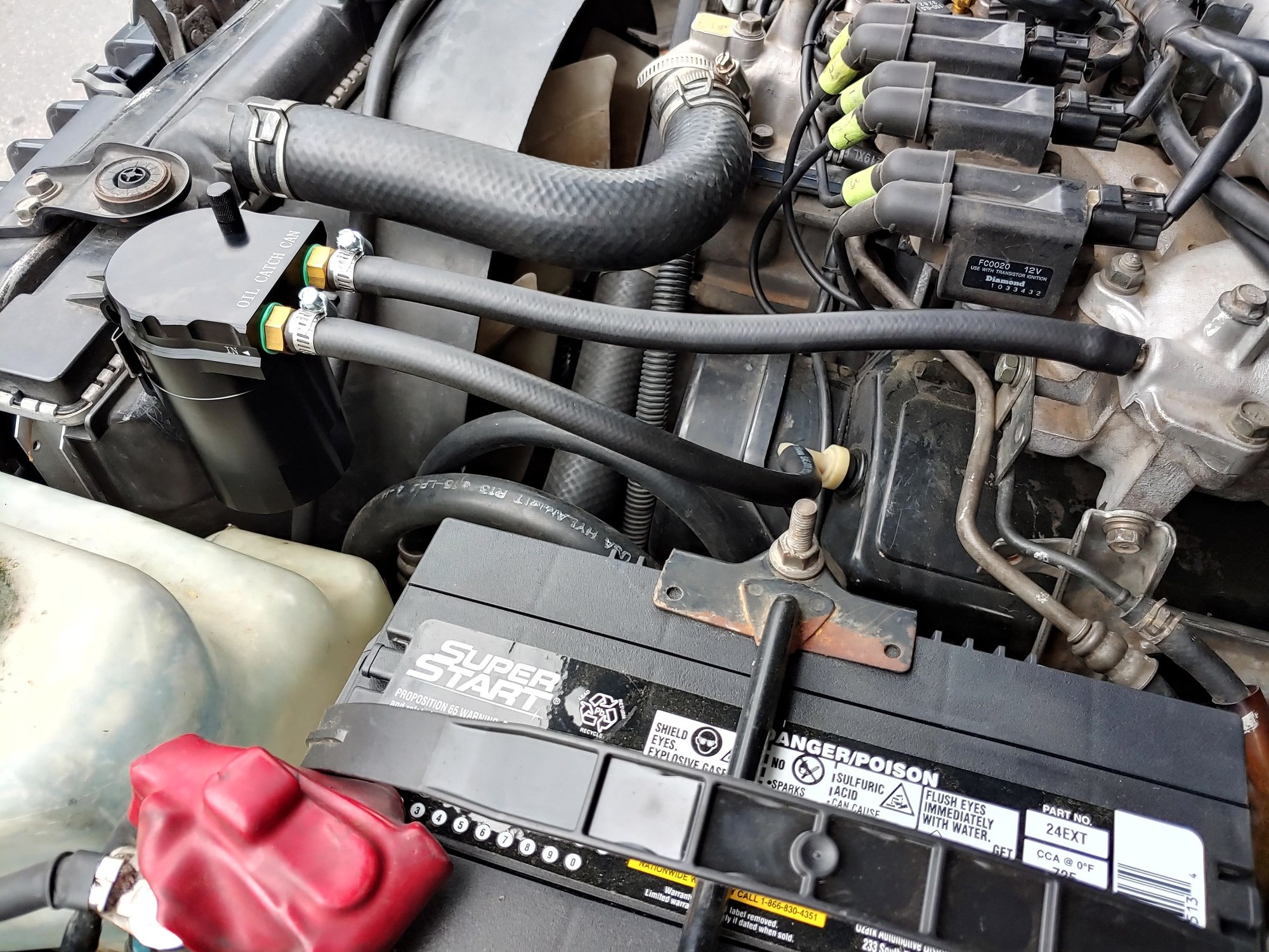

I just used a generic $25 kit off amazon. As far as routing goes, I'm still trying to figure out a permanent setup. As it stands I have it resting in a vacant spot on the passenger side fender well so there's tubing being routed as neatly as I can to the other side lol. Here is a picture of my dirty engine bay. I haven't had the time to clean it or find a proper mounting solution. So far my ideas are to either do a overflow tank relocation/delete and mount it there, or mount it somewhere all the way on the passenger side.
UPDATE: Picture below was before I redid the catch can routing

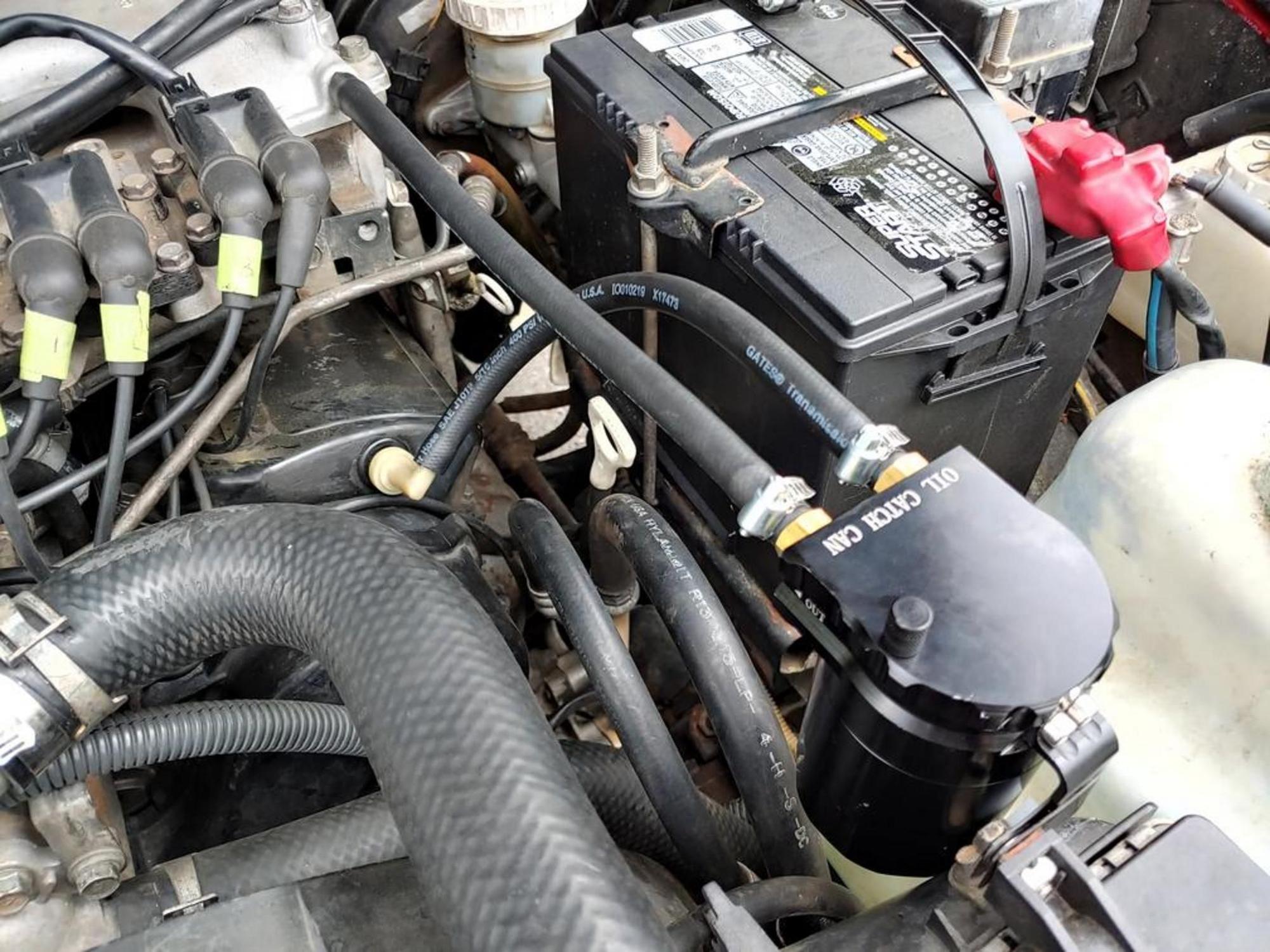

Alright, seeing that catch can resting there again got me motivated to come up with a solution. And here it is!

I like how you mounted it after round 2. Nice easy access. I think I'll go with similar set up too. Looking at how much crank case gasses get recirculated into the intake (judging by the amount of residue and soot in the intakes) I'd like to mitigate that on the fresh rebuild.
