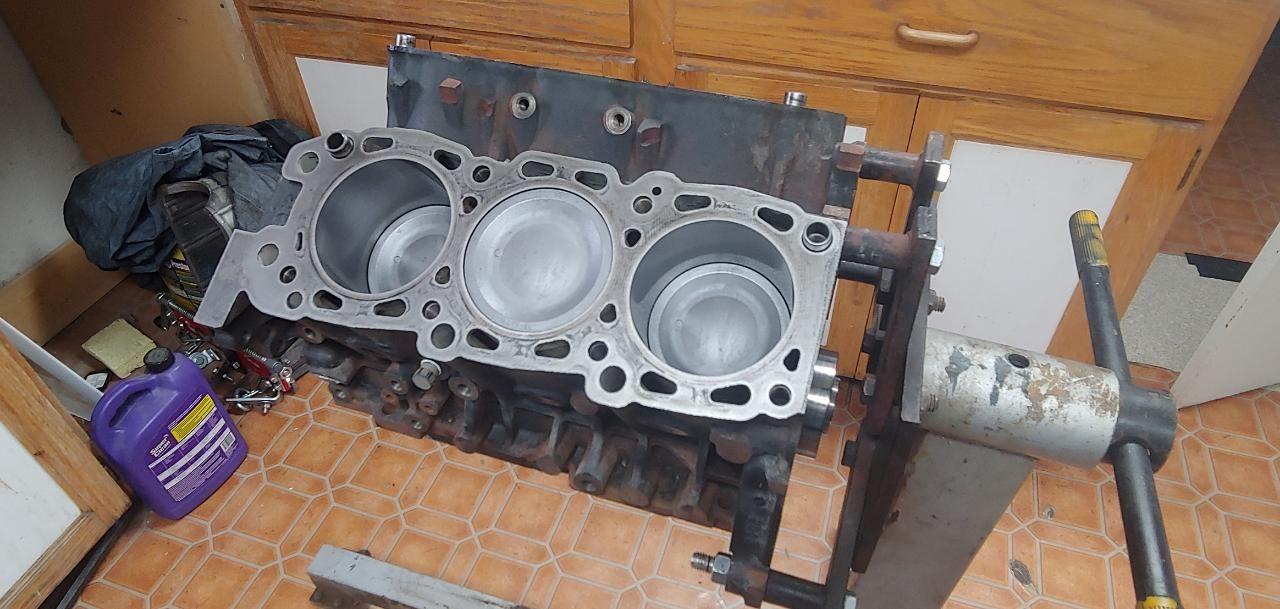

Well folks, it looks like Christmas came early this year. Look what Santa brought from his workshop to mine 😁😁😁
My machinist did an amazing job. He did have to bore pistons 0.050 oversize. The scratch from the blown piston was a little too deep. Got all new pistons/rings, main and rod bearings. He also cleaned/reconditioned the heads. When he worked on the heads he found that on the blown cylinder all 4 valves were slightly bent. You can't see it with the naked eye, except when you micro them. If you line them up just right you kind of sort of can see it. Not sure if photo shows it well enough. One valve guide was cracked and couple guides on the heads were worn past the specs, so those got replaced.
When I dropped off the engine, I talked to the guy that I will do the final asemby myself in order to save some cost. He was totally ok with that. Since I like to do things by the book and not half a**, I was honestly starting to stress out if I can do good quality engine assembly under conditions I hand with tools I have. I tried to educate myself by reading FSM, reading a hundred online posts on how to do engine assembly the right way, binge watched too many videos from the channels I trust on how to do good work on engine assembly... I was ready, but with butterflies in my stomach. On top of that I had a page full of questions for the guy, to make sure I got assembly/break in done right according to his quality parameters. I get to the shop, the block gets lifted on the hoist... and I don't see light shining thought the cylinders... Instead I see pistons in every cylinder hole 😲 The guy says - "I wanted to make sure it all spec'd well after assembly and my micrometers are probably (haha) better that what you got at home, so I just put it all together... No extra charge."
What relief...
So... I got a short block and heads, nearly ready to reassemble. I'm waiting for the results of testing/cleaning fuel injectors. I had to send them out, since my local shop said their tester is broken and not going to be repaired any time soon with this COVID-19 situation. I'll update you when I hear back about that.
I have to order new seals for cams and I'm going to throw on a new oil pump. This way I figure I truly will have an engine with zero miles on it. It's going to be a fun couple weekends 😁
My new block. Looks much better than when I got it apart.
