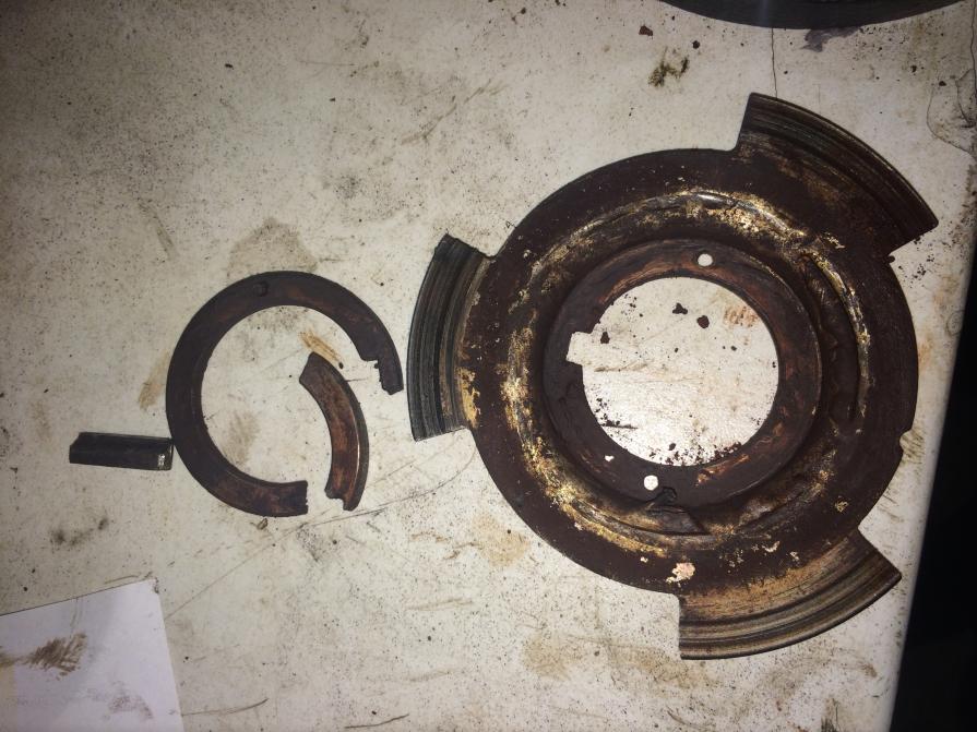

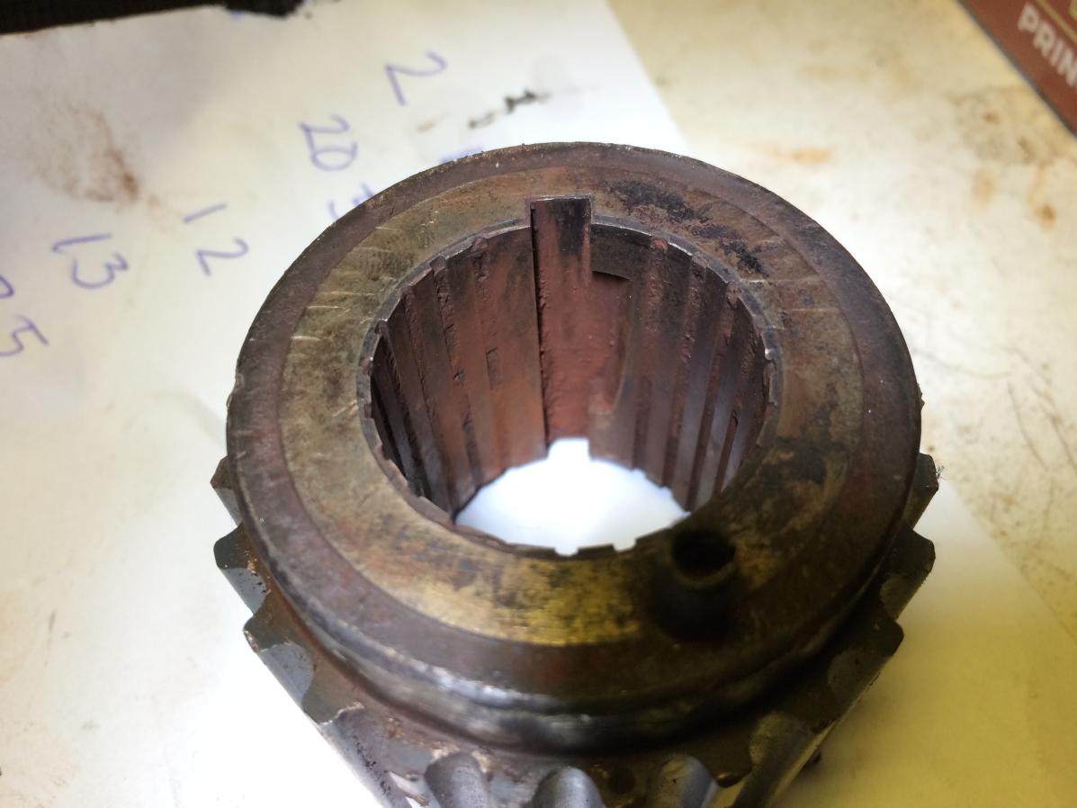

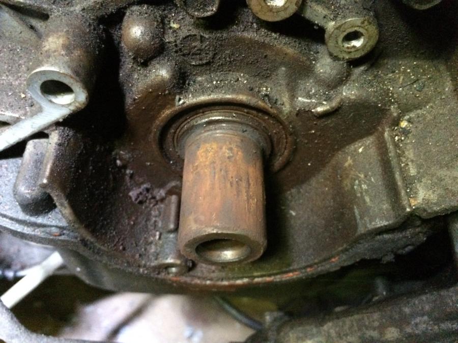

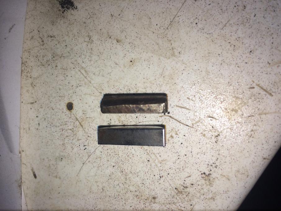

Hi,
I got some photos, I´ll hope it will be seen here.
You could see on the pictures that the splines is gone in the gear.
And the wedge is badly torned.
And the spacer behind the senorplate is broken, so it all can move and scratch the crankshaft sensor. The pins that holds the plate and the spacer to the gear is also gone. So the plate won't spin.
Attached Thumbnails Running Weak-img_1112.jpg   Running Weak-img_1080.jpg   Running Weak-img_1083.jpg   Running Weak-img_1084.jpg   Running Weak-img_1107.jpg

The issues was this,
On my -97 it was that I couldn't get i to run properly. Just wouldn't revs up and got very hot.
The combustion took place in the manifold instead of the cylinder.
So I figured it has to be a ignition problem.
And my other car, -98 the previous owner just going to the store and it just wouldn't start.
So I thought that this time I should start by checking the camshaft sprocket.
