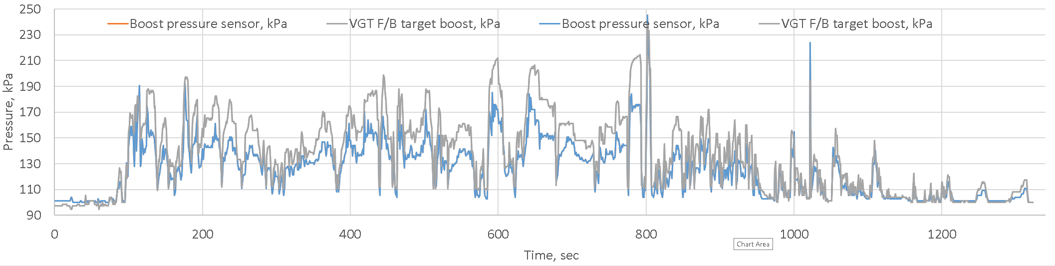

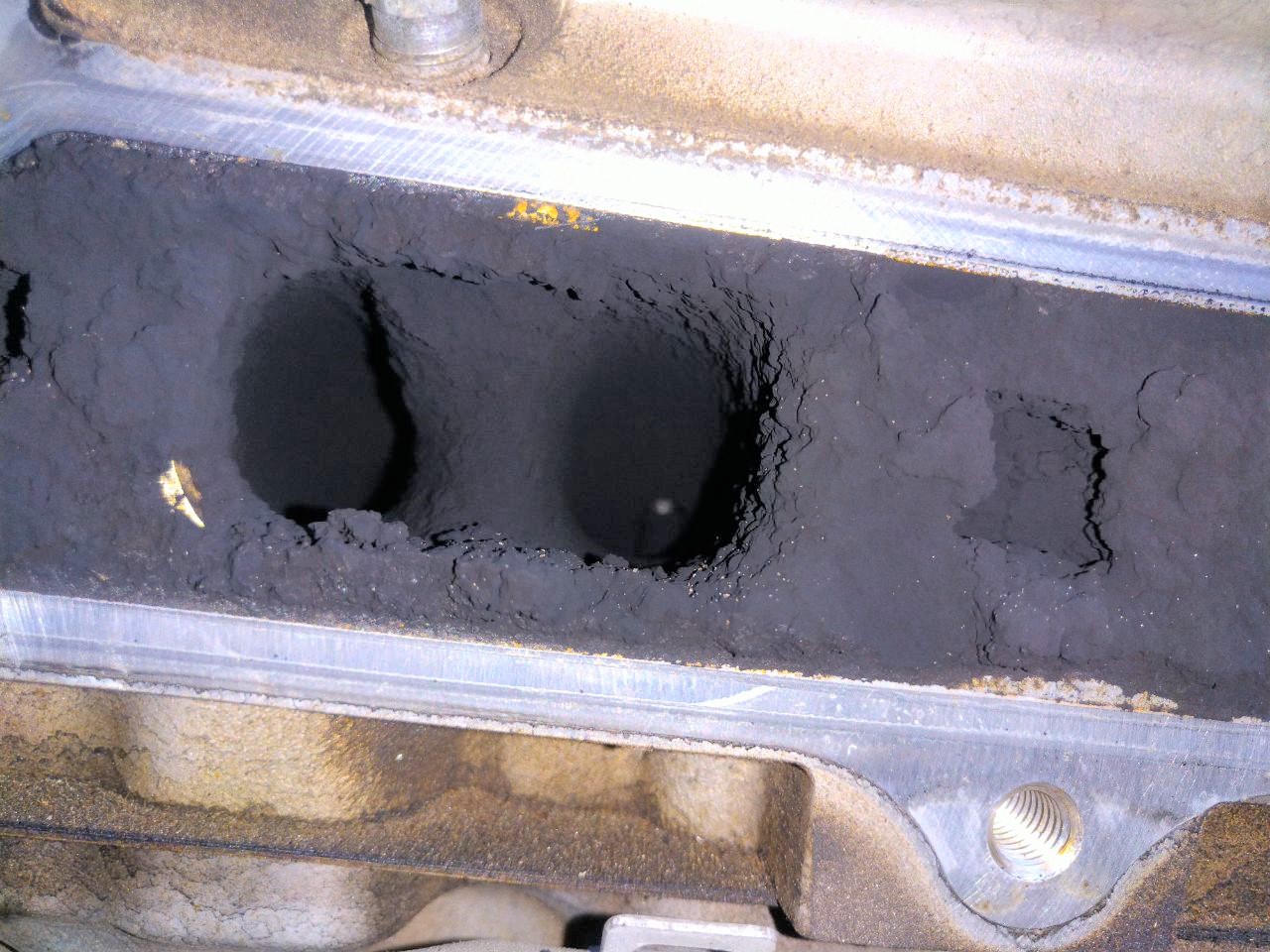

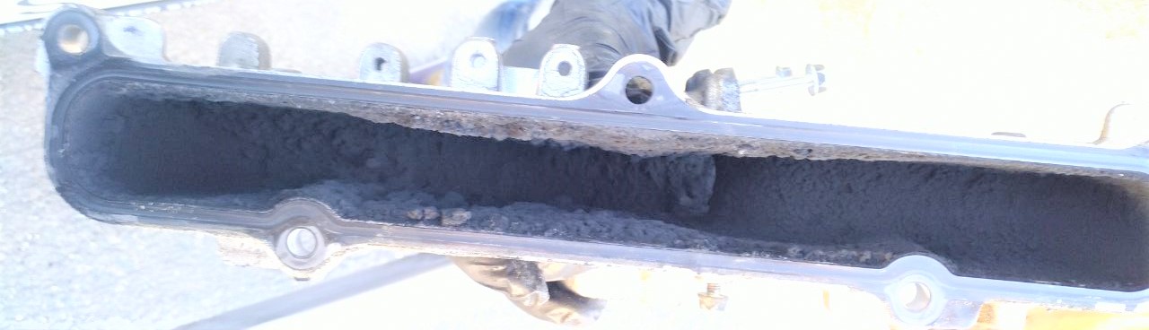

What I did a couple of years ago on my 2.2 DiD from 2013: I've opened the air intake manifold and cleaned it from soot (attaching pictures just to scare you :-) ). As well as the throttle valve was cleaned. I've changed also the hose between intercooler and throttle valve because it was leaking and loss of power and black smoke were noticeable, however I've seen difference on recorded pressure data (see pressure plot) but got no fault codes, and that was strange. Also, EGR system was quite clean, I was expecting the opposite.
