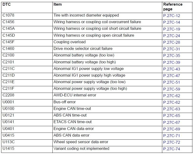

I suggest the OP should download the Service and Body Repair manual from this forum first. While what has been suggested here makes sense a lot of things can cause the problem (see the attached image with AWD related DTCs).
A cheap code reader is a good investment. Once the proper DTC is identified, the manual offers solutions. If the size and the pattern of the installed new tires are the same my best guess is that the tire shop overinflated the new tires. I doubt that tire shops would care to read the recommended air pressures. What would worry me is that the OP claims that the front two tires lost all thread. It is not normal to have such a profound difference in the threadware unless the history of the tires is revealed. The OP did not report any warning light before changing the tires despite they had vastly different threads in front and back, so the uneven thread is unlikely to trigger the warning light. If no ABS failure light is triggered one can safely eliminate the wheel speed sensor failure but DTC reading is the key to start the problem solving.
