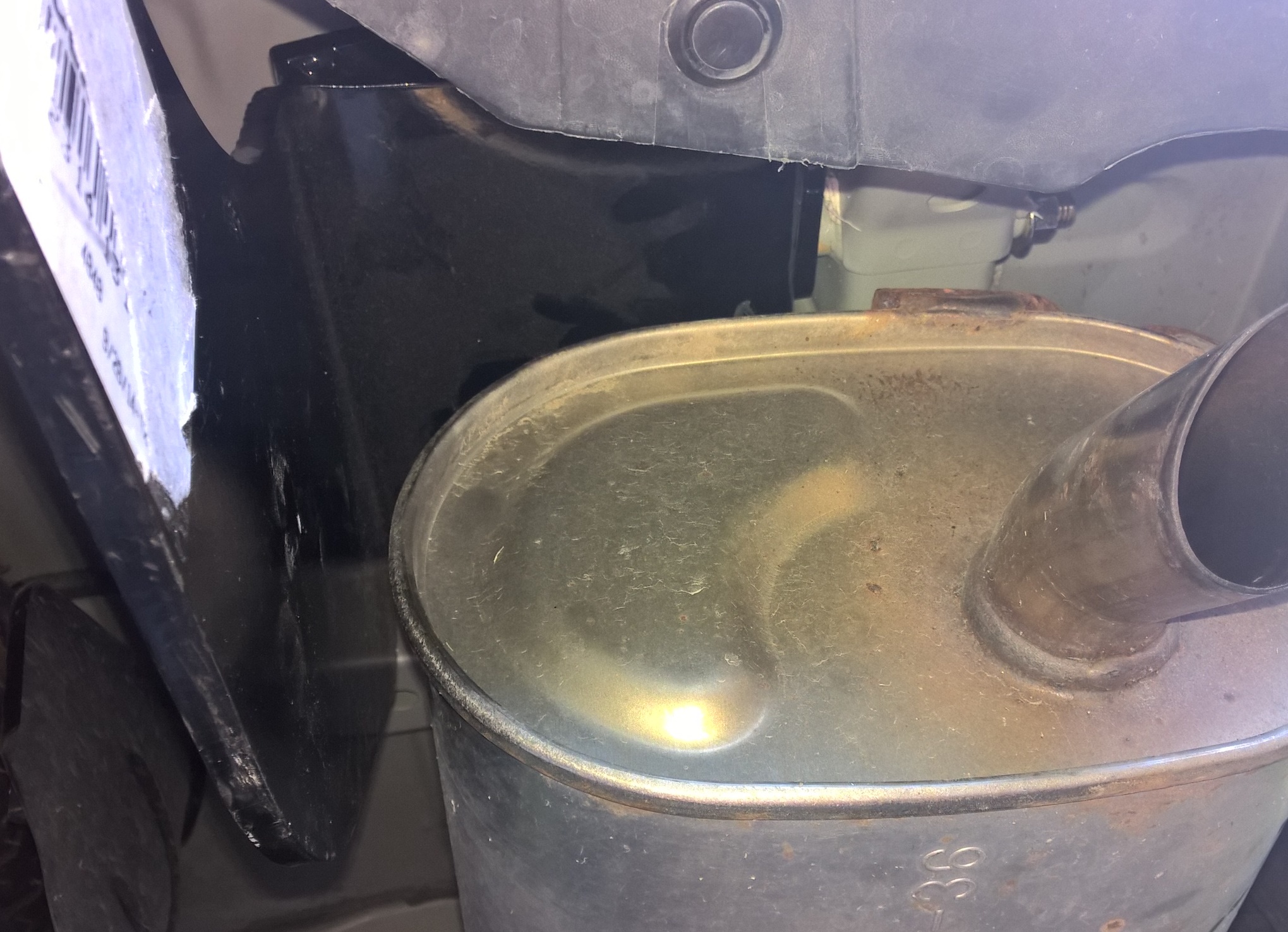

I did an install thread on the Curt hitch on another forum.
Curt hitch is beefy and it bolts up pretty easy. I put one on the wifes 14 Outlander, but it's the same for the 16.
I had to call Curt Hitches and discuss some clearance issues on the muffler side. They sent me another end plate and longer carriage bolts. They've fixed the issue. There's nothing wrong with the hitch I've got either, I just had to use an end plate on each side of the frame on the muffler side. I've seen the dealer hitch and it is tucked up a bit more but I'm not sure it's as stout as the Curt unit.
Attached Thumbnails 2016 Outlander-Trailer Hitch-wp_20150730_10_49_39_pro.jpg   2016 Outlander-Trailer Hitch-wp_20150730_10_49_57_pro.jpg   2016 Outlander-Trailer Hitch-wp_20150730_10_50_46_pro.jpg   2016 Outlander-Trailer Hitch-wp_20150730_10_50_13_pro.jpg

Interesting. Hard to tell from that pic but it looks like the 14-16 version of the curt hitch does not stick out from the back as much as the pre-14 version. Might be that the hitch itself is significantly redesigned beyond just the new round metal, or the car body is. So many posts on hitches from the pre-14 Outlanders. Almost think they should make subforums by generation. So little info on 14-16. As far as oem, I am gathering that it is actually up into the bumper through a cut out. But no pics from anyone so cannot confirm. Also, if anyone who does have an oem on a 14-16 hitch replies, does the harness actually have to be run up to the battery like the Curt and Tow-ready? Or is it truly plug n play with the connections to the rear of the vehicle?
