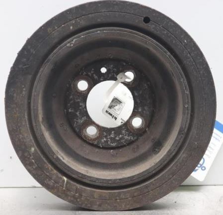

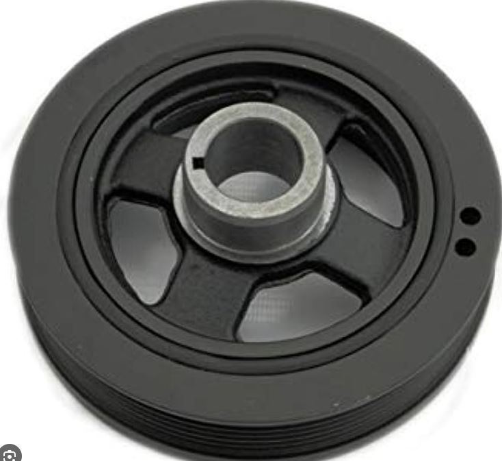

Originally Posted by Kubban
Hi I have outlander 2.0 09 model and tried to do Campbell but I was stuck with crankshaft pulley. I removed 4 small bolts but I was not sure either I need to remove middle big bolt or pulley should come off without removing big bolt. Please provide some assistance. Regards
If your pulley looks like this, I assume its just the 4x bolts and it might just need a tap.
But this style will be held by the center bolt....
Thats as much help as i can give....i sold my Outlander years ago.
